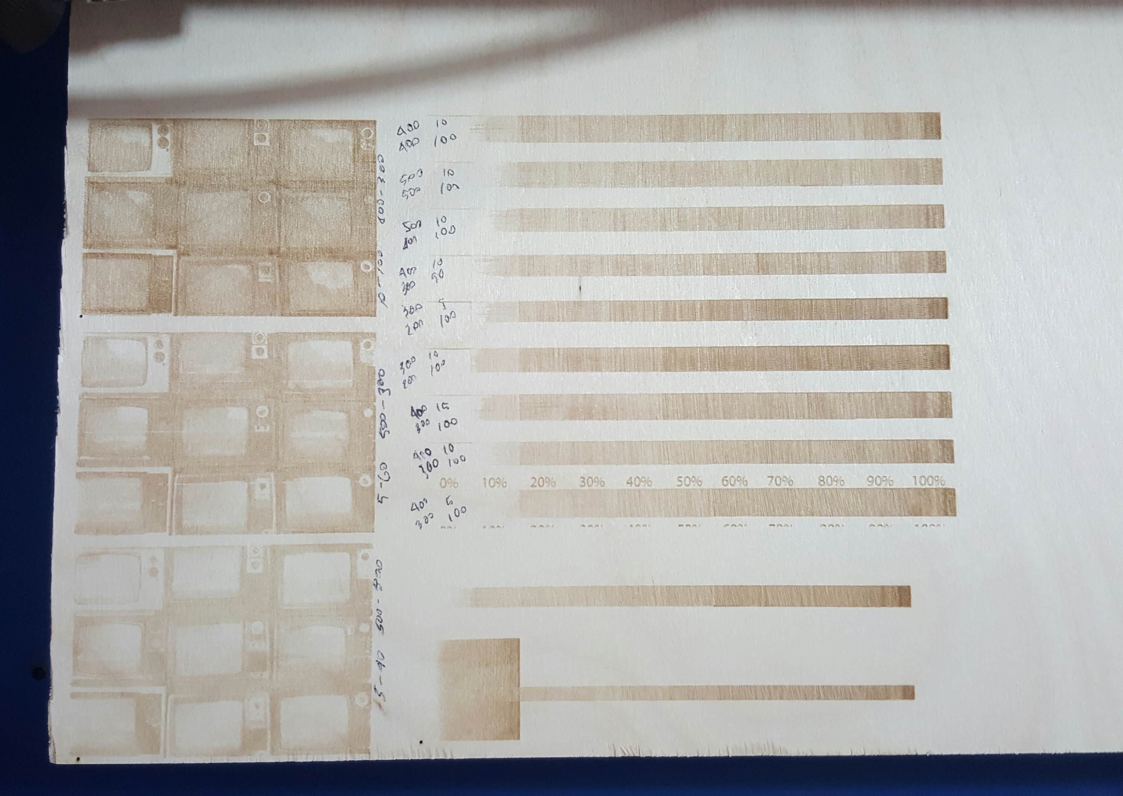

Defenetly Baltic Birch is a very good choice
Very nice results. Especially the last 2 on the scale.
I think you need blacker blacks, but I totally agree.
How does it cut. All the Baltic here uses phenolic resin for glue and just chars like crazy.
@Joe_Spanier I wouldn’t expect much difference since I bought this on amazon
@Joe_Spanier I’ve cut a fair amount of Baltic birch. It does char fairly easily but with some experimentation you can get the speeds/power to a point where the kerf is somewhat discolored but the faces are clear.
I cut a lot of birch. But this stuff is like charcoal when you cut it. And it takes multiple passes on a 100w laser. Nasty stuff. Cnc’s great though.
