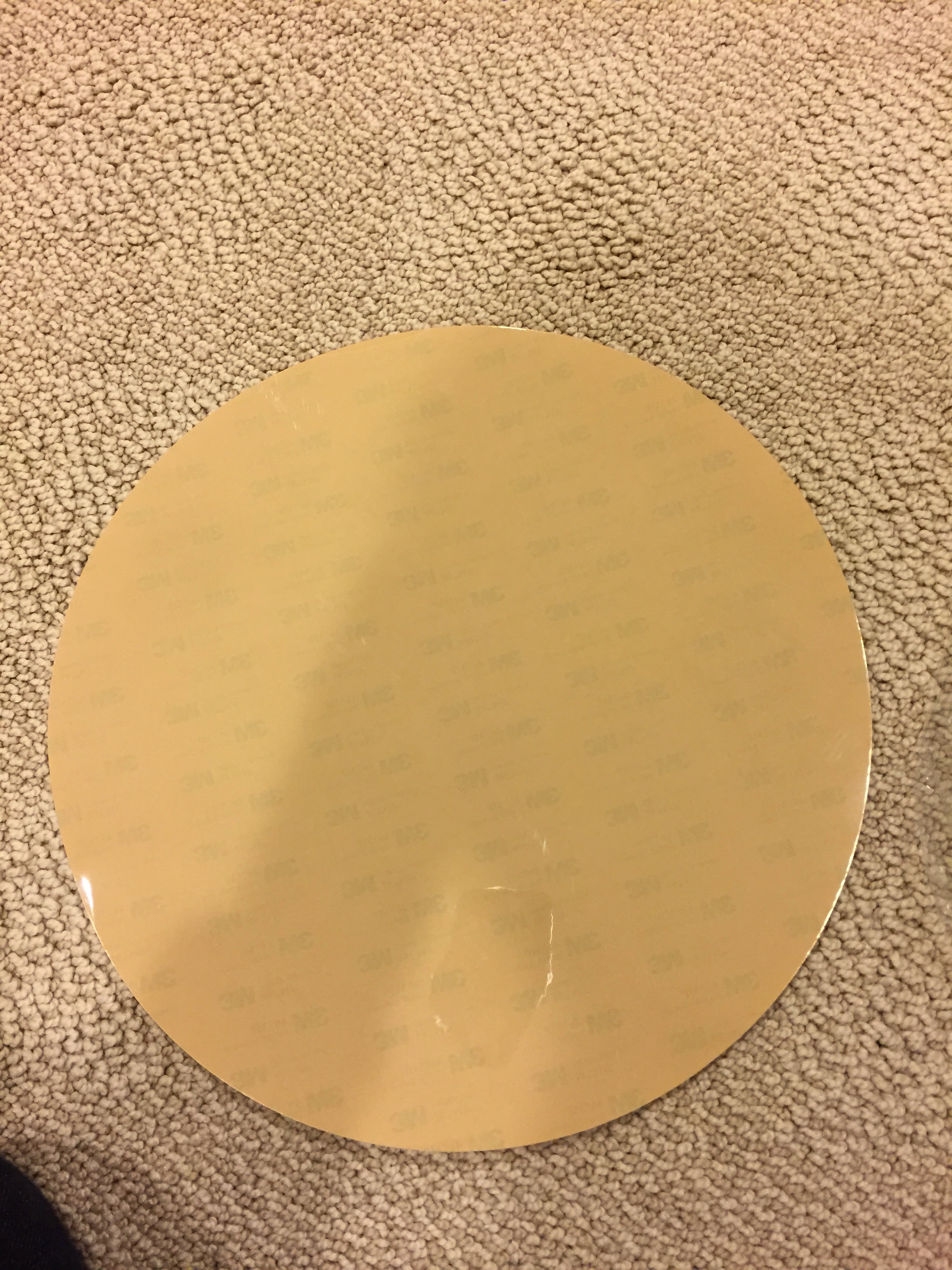

@Steve_L well I tried attaching this one yesterday and it came out horribly:
Tacked down before I was ready (and off center) and like a fool I pulled all the adhesive off instead of working it slowly. Looks like I’ll be ordering a new sheet. You would recommend 5mil with 5mil adhesive? Do you think the extra 3 mil of adhesive makes a difference? I’ll also do matte side up. missing/deleted image from Google+
I have used CS hyde PEI with abs. Absolutely no adhesion problems with the glossy side. Try it first before you sand it. I think you will like it.
