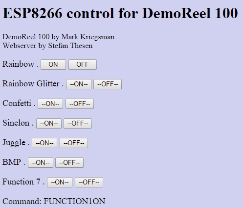

DemoReel100 on an ESP8266 WebServer :) DemoReel runs solely on the ESP8266 - no
DemoReel100 on an ESP8266 WebServer :slight_smile:
DemoReel runs solely on the ESP8266 - no Arduino / Teensy needed.
The HTML formatting leaves a LOT for improvement. Maybe someone with HTML skills can help to make it look good?
Just posted a new code here
http://pastebin.com/KRcPFqm0
On Huzzah used Progmem: 21% and 44% of dyn RAM,
that means there is plenty of space left for the HTML page.
Yes I would make a table in html that would clean it up alot!
Tables are for tabular data. Use css.
Put it on github, I’d be happy to put in a patch.
i like it… retro. reminds me of geocities… got any animating gifs?
@Scottie_D369 @dougal my first shaky attempts on HTML, but I got a table working. Brand new code is here:
Would be nice if you guys could brush it up neatly. Maybe a slider for brightness control would be cool.
Sorry @Juergen_Bruegl I would love too but not at this time. Too busy with other projects. I do have a plan for a pixel project real soon so I can come back to this in about a month or soo when I get the parts.
