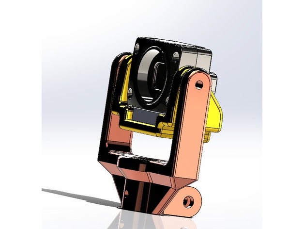

Designed and printed a camera mount for,
  • Point Grey Firefly MV Camera
  • 12x12x30mm Cross laser module.
The adjustable mount allows tilting the camera around its optical center. Also, the laser module axis goes through the optical center as well. Compatible with gopro mounts.
Nice!
Nice clean print! What printer?
Thanks Jeff, it is the original Rigidbot Big.
