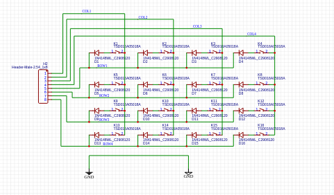

The Schematic
As we can see above, the schematic is very basic. 16 switches, 16 diodes and a single 8-way header pin. Pin 1 to 4 on the header is connected to Columns 1 to 4, and Pin 5 to 8 is connected to Rows 1 to 4.
The diodes prevent “ghosting currents from flowing into other keys in a row when multiple keys are pressed together. They also seem to help with other stray signals and interference.

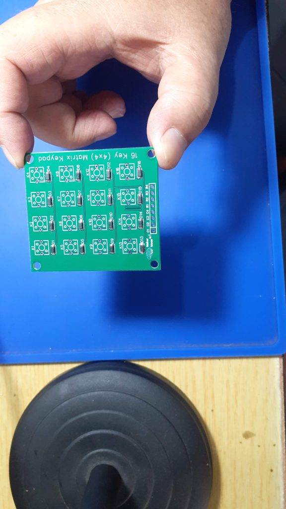

The PCB

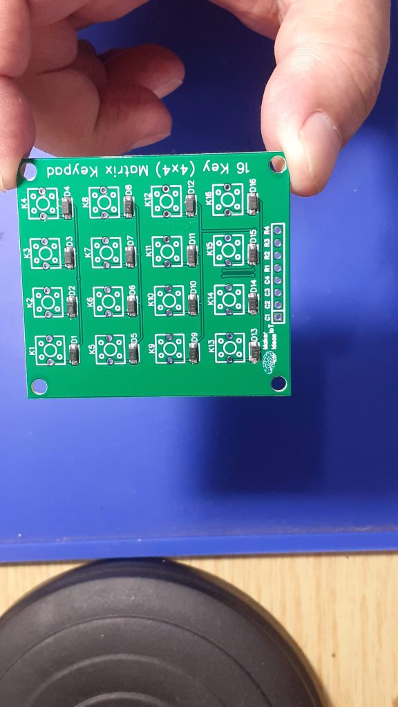

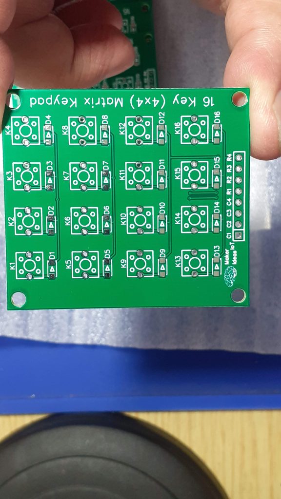

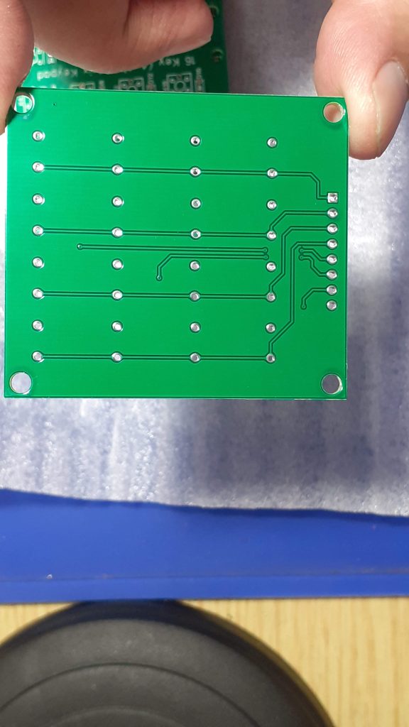

The PCB is a simple double-layer board. All components are mounted on the top layer.

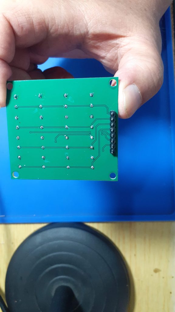

To limit interference from stray signals, I have routed rows and columns on opposite sides of the PCB where possible.

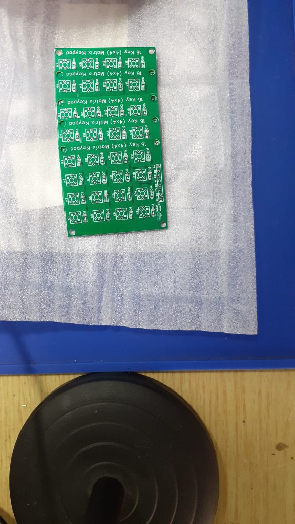

Manufacturing
The PCB for this project was sponsored by PCBWay.

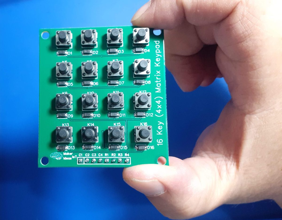

This project does not require a lot of specialised equipment to assemble. The SMD diodes can easily be soldered by hand, the same with the switches and 8-way header. In my case, I chose to solder the header pins on the back of the PCB, that way, I can later use the keypad in a suitable enclosure without having wires in the way.

This code works very well and allowed me to verify the correct operation of the keypad.
