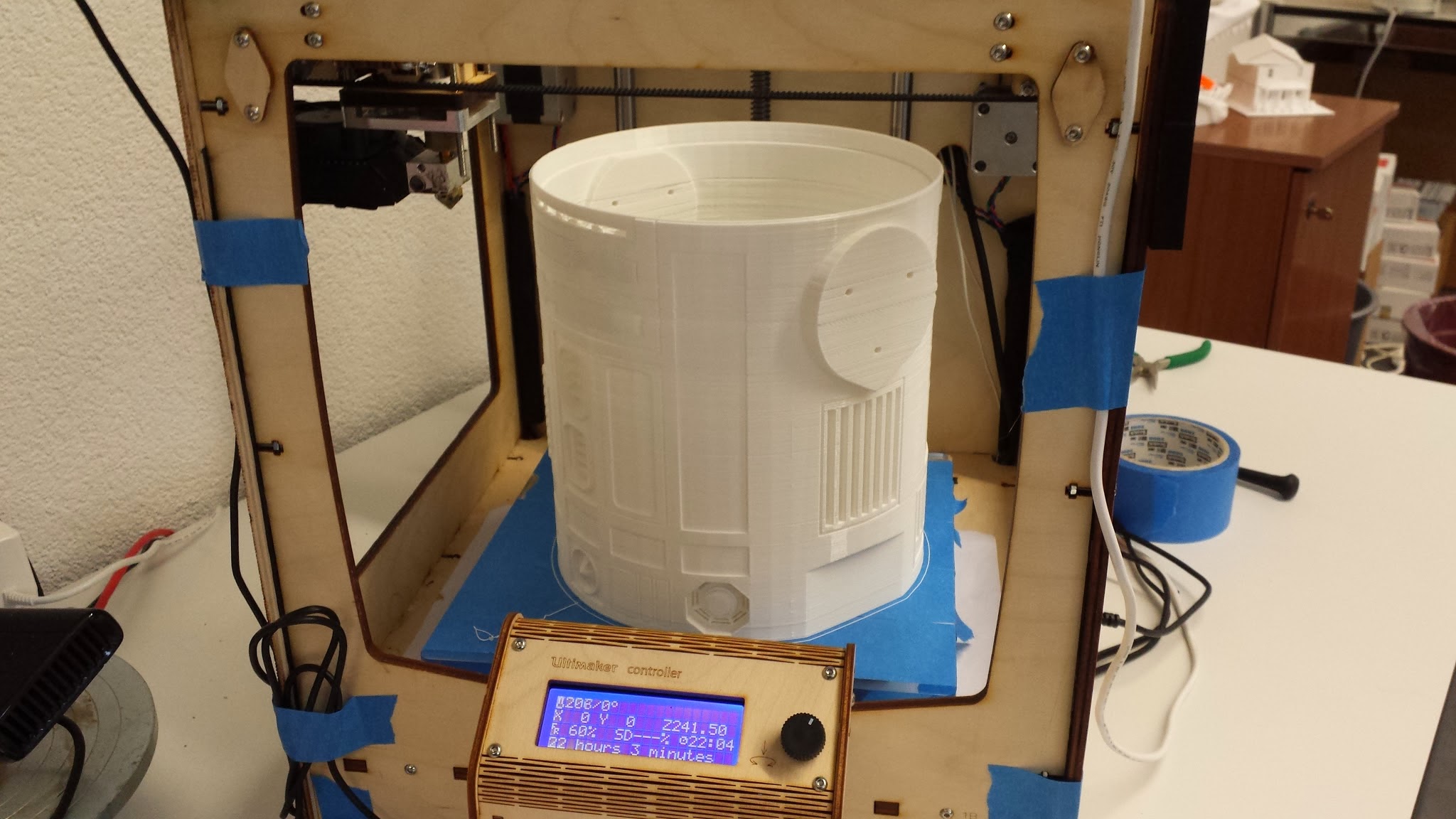

Despite 0.3mm layers, this print took 22h 3min

printing 0.3mm layers @ 50mm/s is critical… will reduce layer thickness to 0.24mm for the rest of the model… @Peter_Parnes Less parts than the Makerbot Tractor^^

What is this blue tape? It seems you use this as a platform for the print? I currently trying out hair spray on a Kapton tape base - it’s okay, but I’m always open to better solutions =)!
The 3M Scotch 2090 blue tape is kind of a standard for us printing with @Ultimaker
painters tape.
Masking tape…
I guess you use it to assure the print stays on the platform and doesn’t peel itself off it. I’m not satisfied currently with my prints on the common Solidoodle 2 platform (Kapton tape)
I use kapton and hair spray for ABS and Blue tape for PLA and belive me i use now blue tape for anything…!!

I was already pushing the limits of flow by going 50mm/s with 0.3mm layers. Extruder kind of broke with this print. Had to replace the bearing in the extruder after that.
