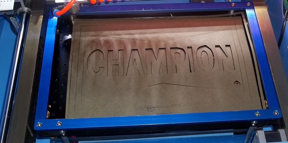

Dialing in my work space by using a template to
define my actual usable cutting area.
Best I can get is 290 x 190. I’m OK with that.
I already know I want a bigger table/laser
