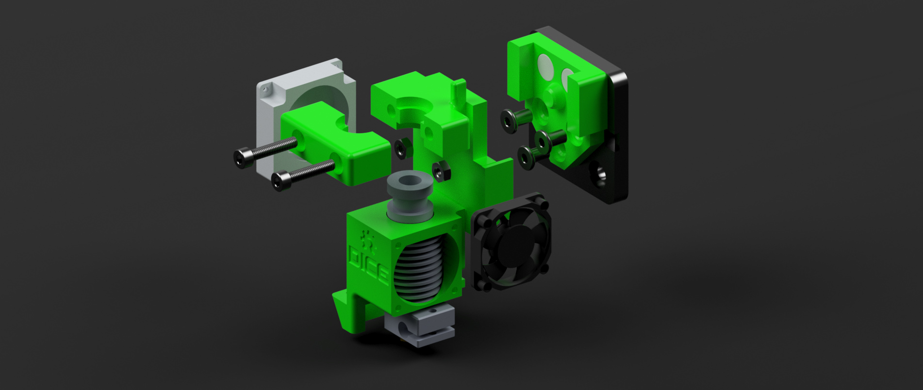

DICE original design uses brass knurled nut heat melted insert method to secure the
DICE original design uses brass knurled nut heat melted insert method to secure the E3D collar. Since these parts will be printed in SLA, the heated method doesn’t look like appropriate for SLA so I added slots underneath to insert regular M4 nuts.
Pinshape STL updated.
Nice, like it a lot. What’s the specs for magnets?
5mm x 10mm round neo. Had to Aliexpress those…
THx for this mod I use this on my core-xy and next on my prusa too…
