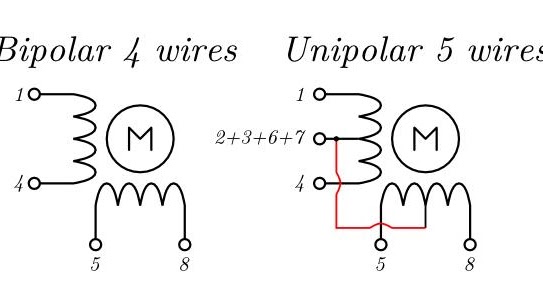

What electrical mods did you do? Cut the 5th wire on the PCB to conver to bipolar?

@Ryan_Carlyle as Daniel pointed out, I applied the bipolar hack. Would you be interested to see a “how-to” video on that?

@Tinkering_On_Steroid was just wondering if you also rewired the coils in parallel instead of series (for speed) or simply did the bipolar mod.
