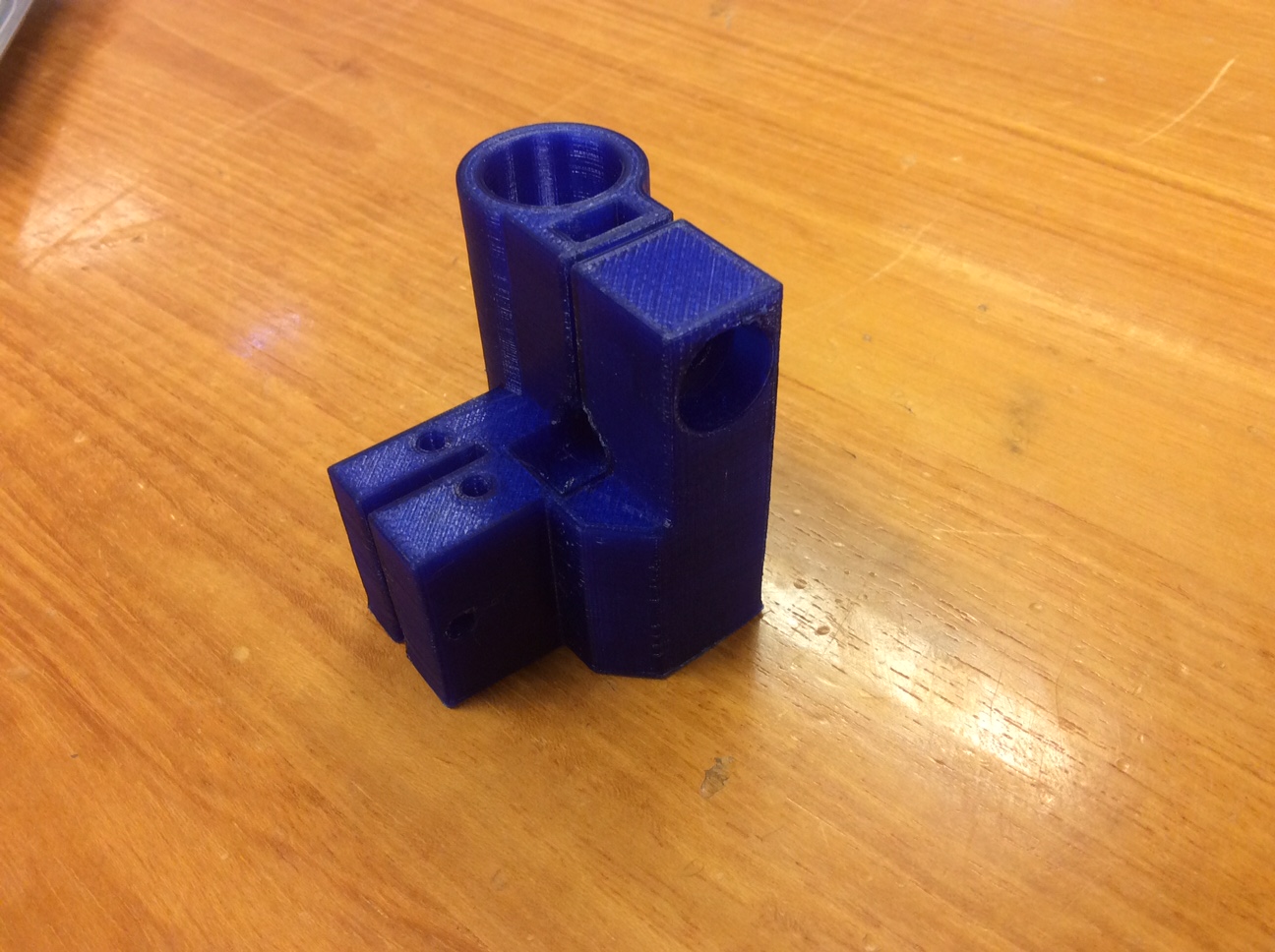

Did a test print on a Ultimaker2 using PETG filament from 3dPrima
First print with this filament. Used 235°c and 110°c on bed (material is listed for 230-250°c). Minimal supports used, no raft and 60% infill
By far the best results Ive got printing this part. A very solid piece… No warps even with this high infill %, and only slight flattening on the bottom probably because the bed is too hot (ABS settings used). I probably can also lower the heat on the printhead, I just wanted to stay within the reccomended parameters for the first print.
