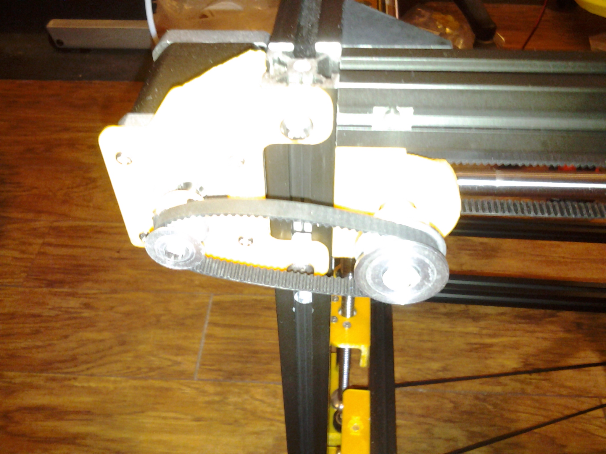

Did anyone else find that the small step motor belts are a little too big? I bought the motor gear on ebay but it has the same specs as the one on the BOM- I haven’t tested it but it seems too loose.
One solution is to add washers on the bearing holder to move it farther away, but I must have done something wrong for the original design to be too loose.
this is on a Eustathios Spider 2
The motor slides down the frame to tension it.
Motors can be adjusted, just lower them.
duh of course! thanks - why I didn’t think of that! That is one of the great features of the aluminum extrusion- parts can so easily be adjusted or removed and put back on. Thanks again
One thing to note is don’t put too much tension on them. Make it tight… But don’t push down so hard the motor mount deflects. That puts the pulley out of alignment and makes the belt track to one side. Then the pulley will rub on the belt introducing artifacts in the print.
Ask me how I know
