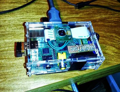

Looks like somebody has build something:
No lens mount yet.
