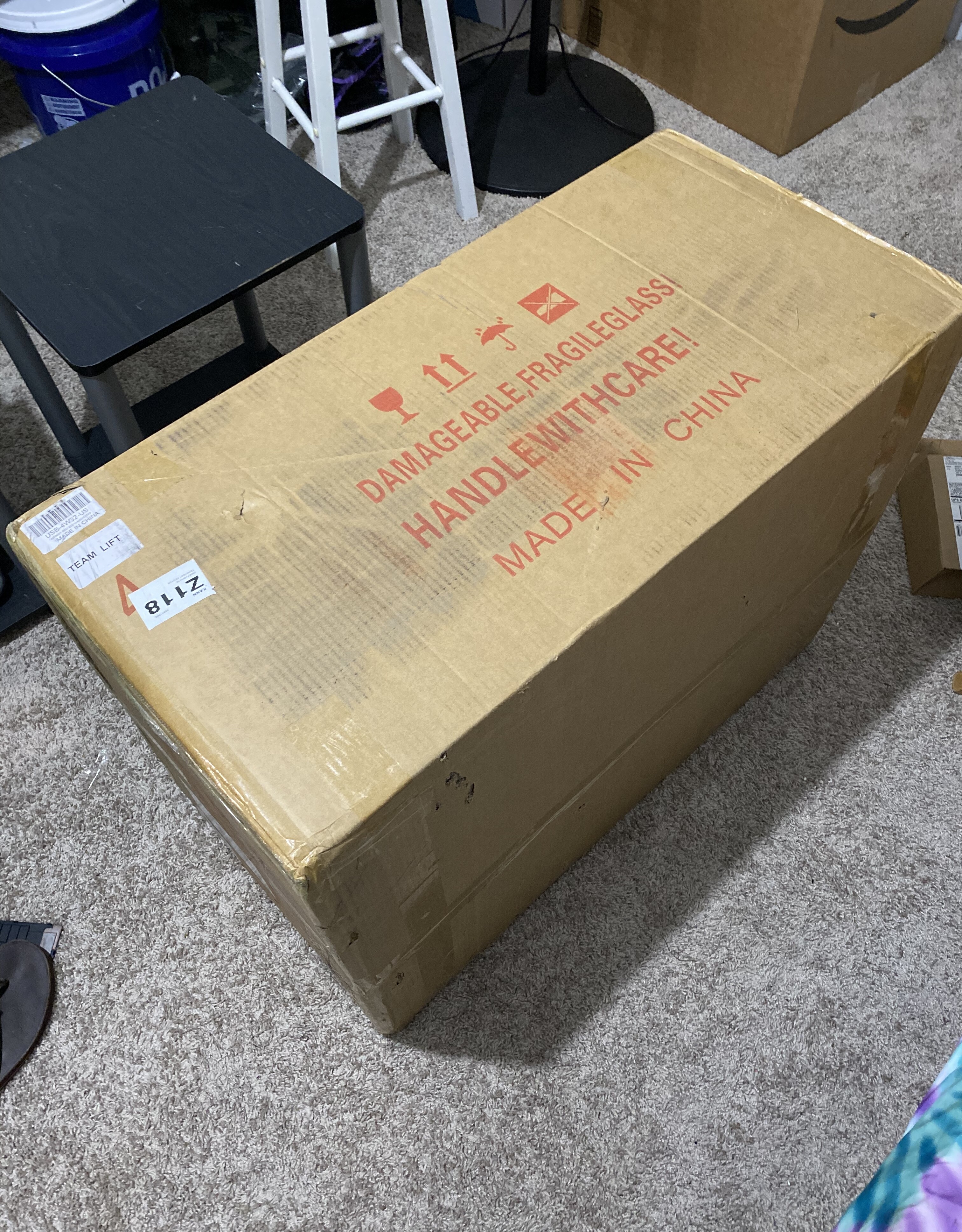

Well it has arrived!
After getting it unpacked from the two boxes it was sent in (one inside the other) I started setting it up with some help from @NedMan. It started easy enough, making sure it was well grounded and the air bubbles were out of the tube… well that took some high tech solutions.
