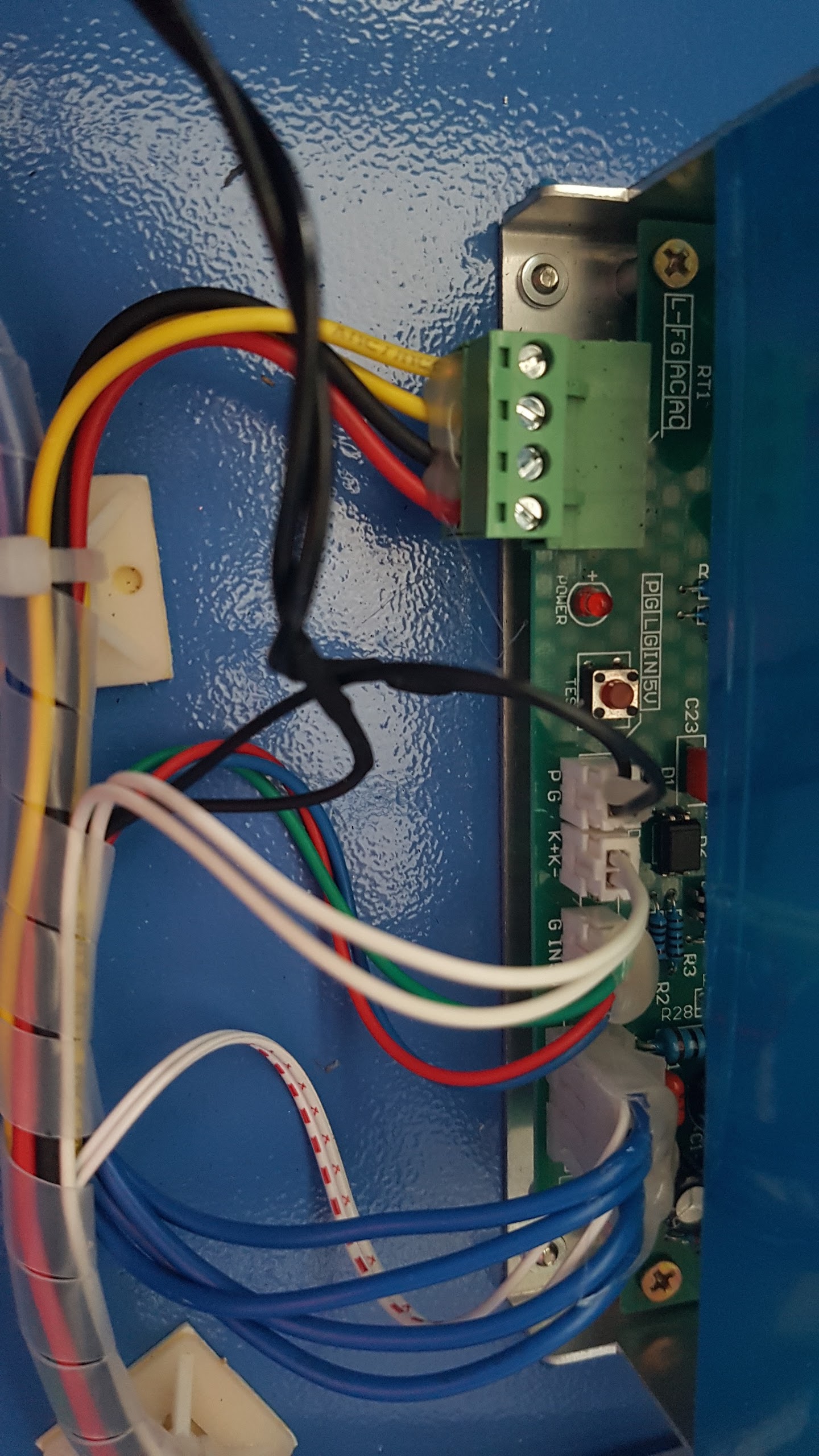

Did my first mod
Microswitch (NO) installed for door lock. Wired in series with laser switch.

glue ? (can’t see any screws)

Yes, I used hotglue for the switch. It should last, and if not, it’s safe anyways because the switch will stay open.
Normally Open contacts FTW!
Nice and simple. I’m going to do my machine the same way. Thank you for the idea.
