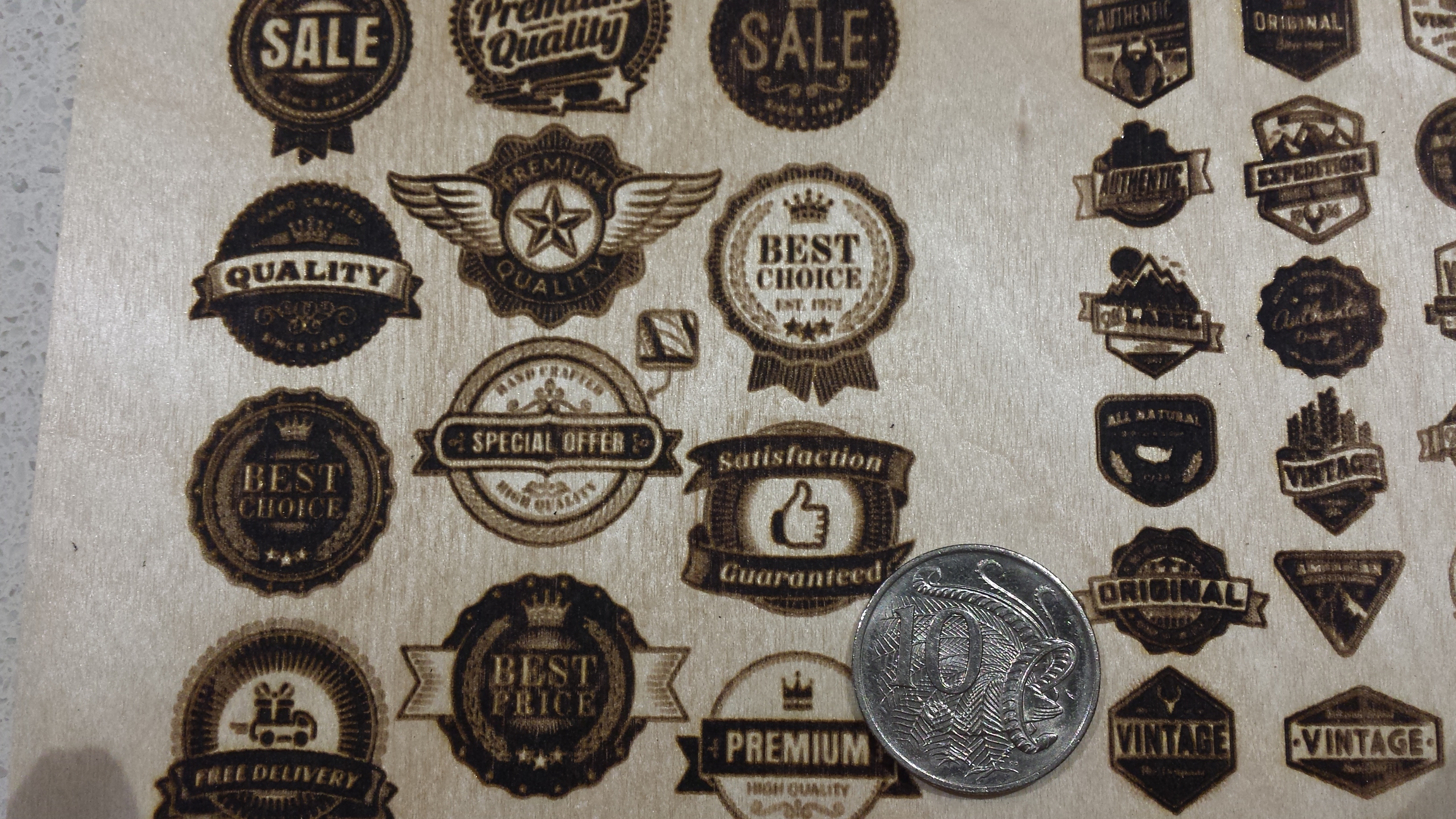

Did some engraving tests to see how detailed I could engrave. So far not too bad.
Nice! Can you share your settings please? I have try to engrave some logos also but with no so good results…
@Kostas_Filosofou i use a bespoke controller, an arduino uno r4 with 10bits engraving. See http://awesome.tech for some details. Settings 380dpi speed 600mm/min yes it’s slow.
thats pretty good man! looks like you might be able to get even more out of it if you adjust your focus a little
