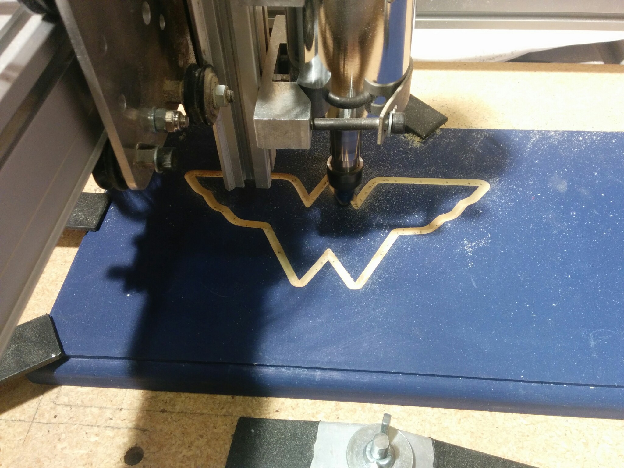

Please annotate (understandably at a later time) these photos to help me (noob) out.
Spindle? Speed? Bit? Feed rate? Paint? Wood? Conversion Software? Image source?
Yeah no problem Matt. The wood was pre-painted (obviously). It is a pine board. I used a 90 degree v-bit for the logo and a 60 degree v-bit for the text.
I have a quiet cut spindle (from inventables) with a feed rate of 5mm/min. I did that rate just to ensure a cleaner cut as the wood was already painted.
Software was inkscape with the svg image converted to dxf and then used f-engrave for the g-code generation.
