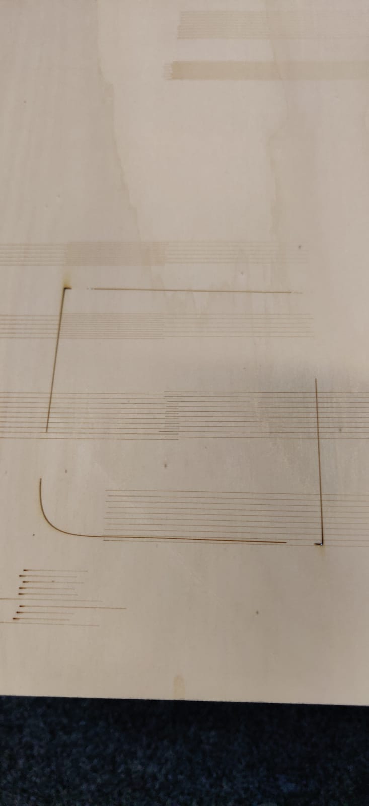

At first trials we have reached at that speed with necessary configurations but after we have tried to scan engrave with laser and have a meaningless results.
Could anyone here to explain us the problem ?

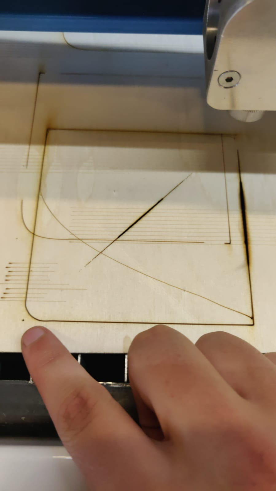

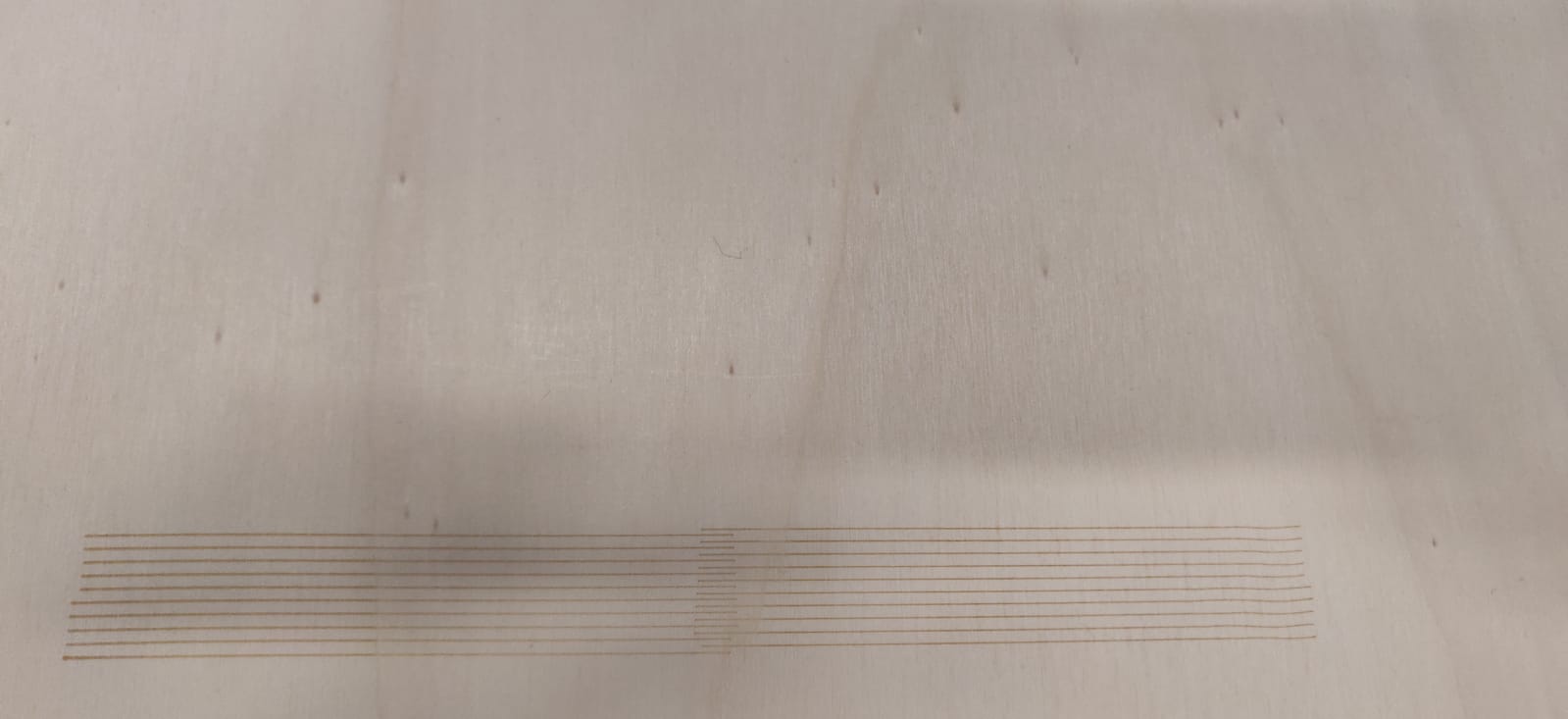

This is a sample laser engraving gcode a gcode which is going back and forth 300mm and each line has a 1mm space between on Y axis. Laser engraving should be between 100mm and 200mm. But as you can see going forth not match with coming back. the laser engraving starts at 100mm correctly while going but it is not correct while coming. We can not determine the problem.
And this is a square gcode for cutting with laser at 1500mm/sec but as you can see it is not a square ? What would be the problem ?

For both cases we have prepared the gcodes by hand. I will send put them here asap. but they are simple stupid gcodes with ā€œG1 X100 S0.4ā€ etc.
@ibrahimuslu Your expectations are way off!
  • A feed of 6m/s is extremly fast. You would need an accelleration of 180m/s2 to reach 6m/s within 100mm! Can your machine realy handle that (without play)?
  • 6m/s at a pixel size of 0.1mm (for example) is 60’000 pixel/s, which meens each pixel only has 16.7us to switch the laser on/off or change the laser intensity. Smoothieware can never handle that and it is also too fast for typical laser power supplies, which accept max. 20kHz PWM!
  • The shift you see at the end of a line could be caused by delays in Smoothieware or the LPS.
We have a really good mechanical design. Motors are getting heat but it can reach that speed. We played with configuration and drop the resolution in order to reach that speed on the motors. configured the drivers and for 10 steps for each signal from the smoothieware.
And a fast laser which working frequency is between 30-180khz.
you have written " (because laser PWM and stepper pulses are generated in different interrupt routines)." But i think you edit it. Is it true? I need to check it.
Yes, I had written that the signals are generated in different interrupt routines, but I’m not a Smoothieware expert, so I deleted it.
What type of laser do you use, that can reach 180kHz PWM?
Have you tried slowing the machine down as previously suggested to see if that improves anything?
High speed aliminium case laser
I havent find the laser spec page. This is the laser we are using on top of it
I will try it next week. I will share the results.
The gcode ive shared below and at 150mm/sec it draws this
