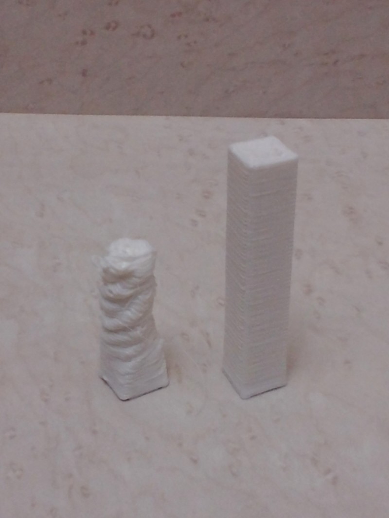

... discovering the value of the cool setting in skienforge....
… discovering the value of the cool setting in skienforge…

@ThantiK I am trying skienforge because I print on Linux and have had incredibly poor results with slic3r (bad top surfaces, inability to scale holes correctly, z-ribbing etc.) I know how to calibrate my machine, as I am getting perfect results with skienforge… so must blame slic3r. Are there any other options on Linux?
@Jarred_Baines It is actually sfact I’m using, which I thought was just skienforge with sensible defaults… Is there more to it than?
