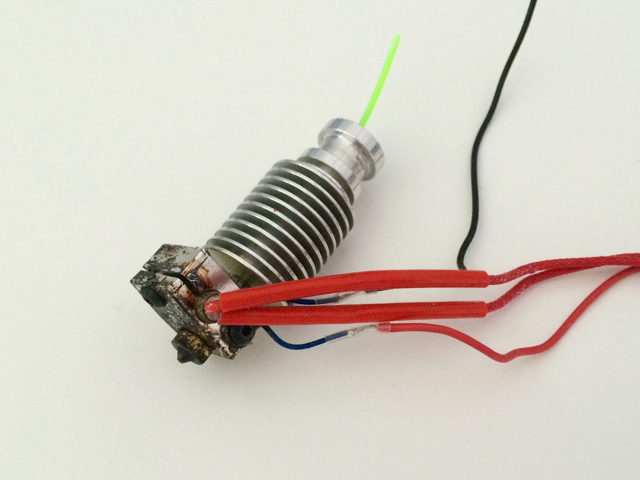

Dismounted my E3D-V6 for its yearly maintenance today. Made some Pics of the conditions after one year heavy beginner-abuse

Anyone knows a lazy way to clean the debris off of the heater and nozzle?

I put the nozzle in a furnace and burn everything off. You can also do it with a torch.

I have a small brass wire brush next to my printer and I give mine a scrub every now and again. The nozzles themselves are super cheap so I just replace those.

I use my little proxxon MicroFlam. You could use any heat source of course but i would go with a flame that is hot enough to quickly heat the nozzle. I always put in on a peace of 1,5mm steel wire upside down. This way the melting plastics can run out and after that everything else turns into smut quickly.
You should of course be careful and have a good underground so dropping hot plastics doesn’t damage anything.

@Evan_Nguyen I use a little lighter-torch thing to clean out mine, put it on something thats the right diameter and press down and everything shoots out the nozzle!
i clean my nozzle when it starts being crappy (usually if i let it sit for a while), I have taken to jamming a sewing needle up the nozzle when its up to tem and that seems to rebore the nozzle and gets my flow back

@Dale_Dunn I had no failures with this hotend. Never, the whole year. It was my first year with 3D-printing, so the hotend was used like a scapegoat
I just disassembled it because I unmounted it anyways…
