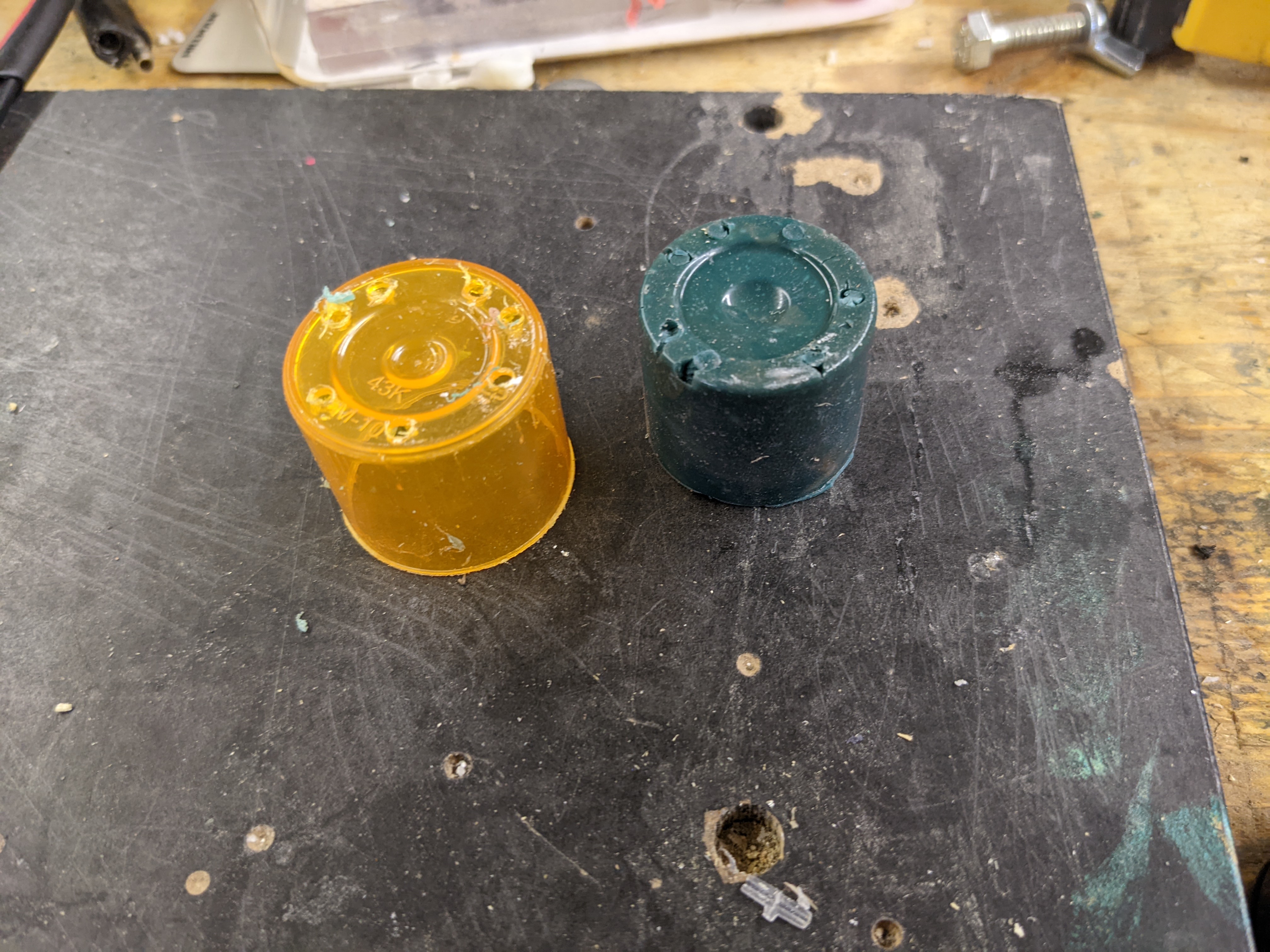

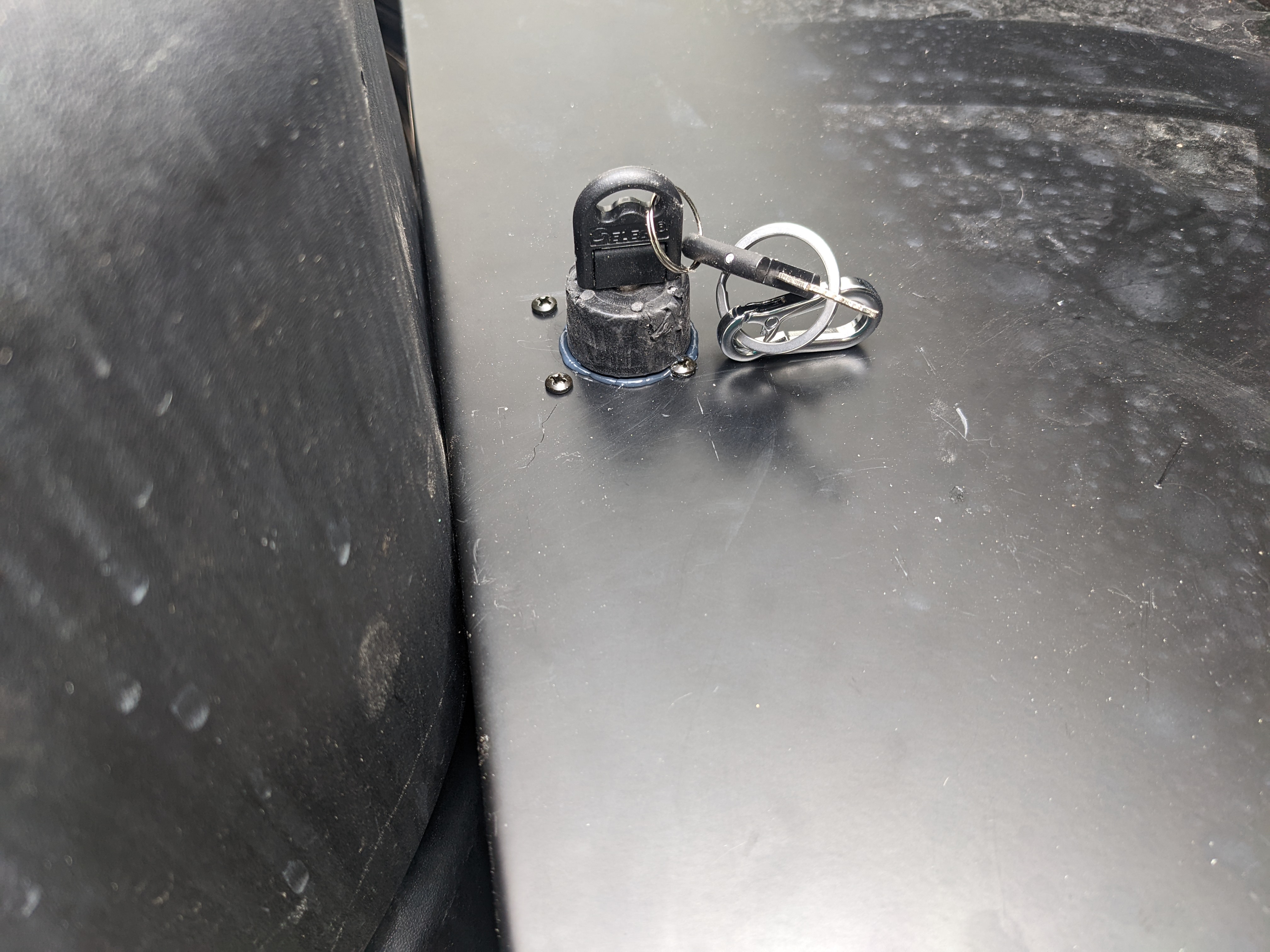

One challenge was the key lock. We could not use the one that was on the front verticle surface because the propane tank was in the way. Therefore we mounted another on the top surface. But how to keep water from seeping into the keyway of the upward-facing lock?
:bulb: :bulb: We made a mold from a medicine bottle and cast a cover with the silicon/corn starch method. After filling the mold the actual lock is pushed into the silicone. After drying the lock is pulled out. The finished cover fits over the lock with a slot cut into the top for the key to enter. Not waterproof but certainly water-resistant. I plan to re-make a black one! The green just violates the theme!

BTW I hated the green key cover so I finally got one that was black.
Most additives I had around the shop changed the chemistry of the silicon and it either did not dry or turned out crumbly.
I ended up using black “milk paint”.
Just a pinch of it added to the cornstarch/silicone mix did the trick.
