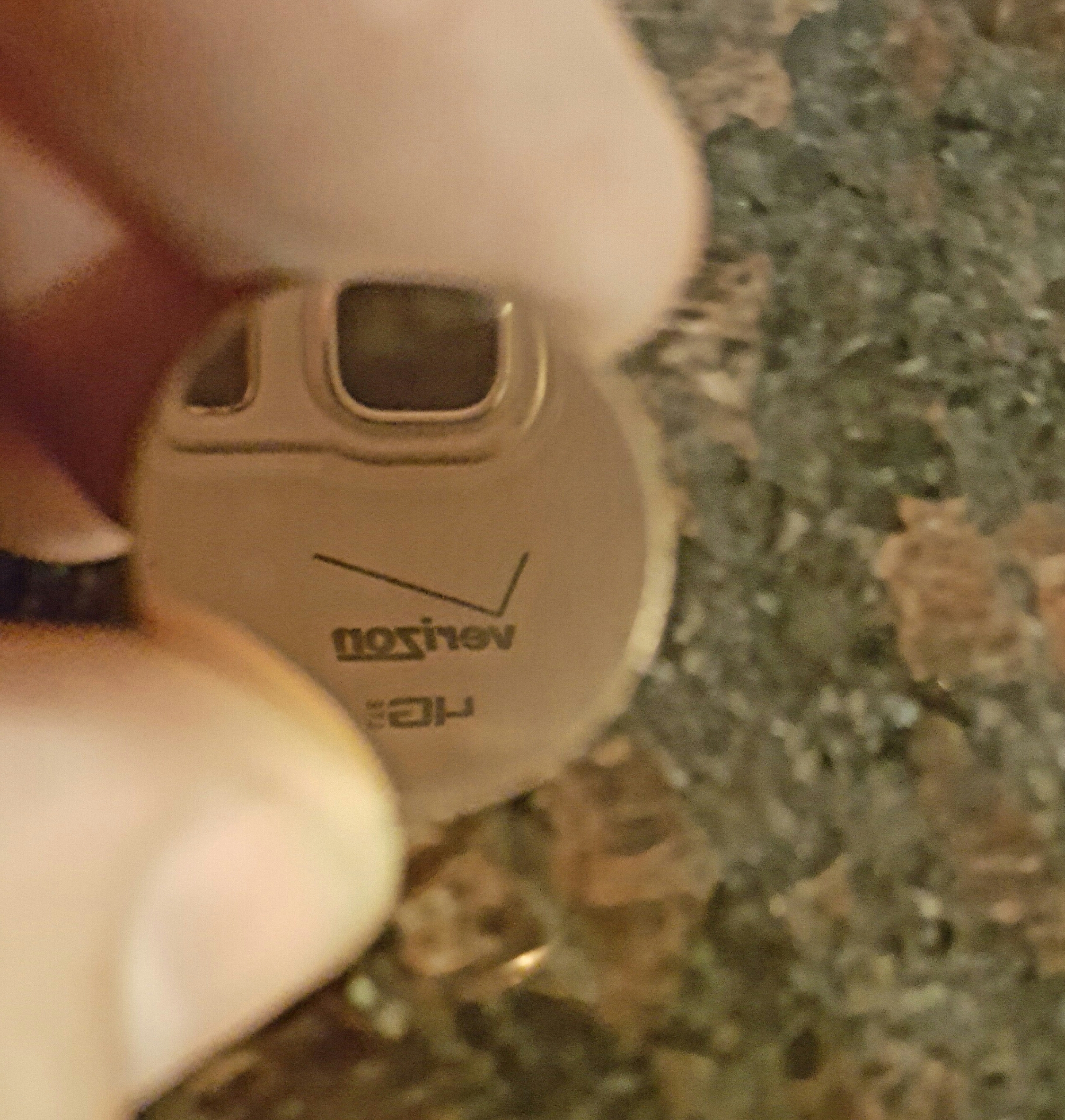

I ordered some 10ga 20mm copper discs and made mirrors from 3 of cleanest. I honed them by hand first on 320 grit sandpaper, then 2000 and then using jewelers rouge and they came out pretty darned nice.
However, after testing with these mirrors, I found the performance to be so close to the original mirrors that I can’t tell a difference. Has anyone else tried Copper mirrors and if so, what results did you see.
