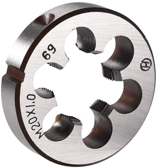

I am working on up grading the optic mounts on my K40 laser cutter and needed to cut down a part and then recut threads. I needed a M20x1mm die which I had to order. The outside dia. of the die is 45mm which is too big for my current die wrench. Rather then buy one, I decided I could make my own.

Where did you get the die?

The die was from amazon.
