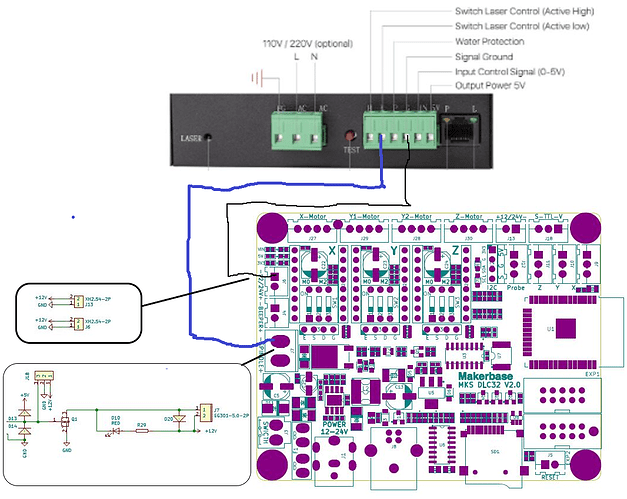

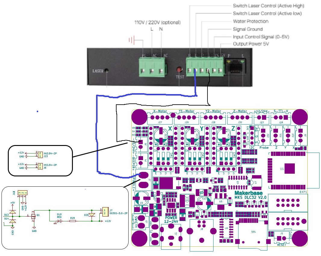

Derived from the information below and without knowing what firmware and how your previous controller was connected, connect:
  • MKS DLC32:J17- [pin 1] to the LPS pin “Switch Laser Control (Active low)”
  • Pick up a ground at J6- [pin 1] and connect to LP pin"Signal Ground"
Check these things before you wire the controller:
  • With power on verify where 12/24V is on J17. It should be the side marked “+”. DO NOT CONNECT THIS SIDE. The other side marked “-” should be the correct pin to wire to the LPS.
  • With the power off, measure the resistance on J6- (minus) to a known ground pin to verify it is connected to the board’s ground.
I would use a twisted pair wire to make the connection.
In the firmware:
  • The port on J17 must be set up for PWM
  • Depending on the firmware used the PWM signal may end up being inverted
  • Depending on the firmware used the PWM signal may not be able to be inverted and another solution may be necessary.

hello don I made the connections as you described to me the laser works all ok my only perplexity is that by connecting it to the spindle - and -24v the voltage that reaches the psu laser Is it 6.6v is there any way to get it to 5v? Can it create problems that is 6.6 or can I leave everything as it is?

  1. Did you verify that 24V- is the ground on the controller board?
  2. Disconnect anything on the 5V on the LPS. With power on read the LPS 5V relative to the LPS ground?
  3. In the same configuration as #2 what does the 5V on the LPS read relative to controller 24- (ground)?
  4. Disconnect the Spindle- wire from the LPS (blue wire in my drawing) with power on what does that open terminal on the LPS read relative to controller 24V-.(ground)
