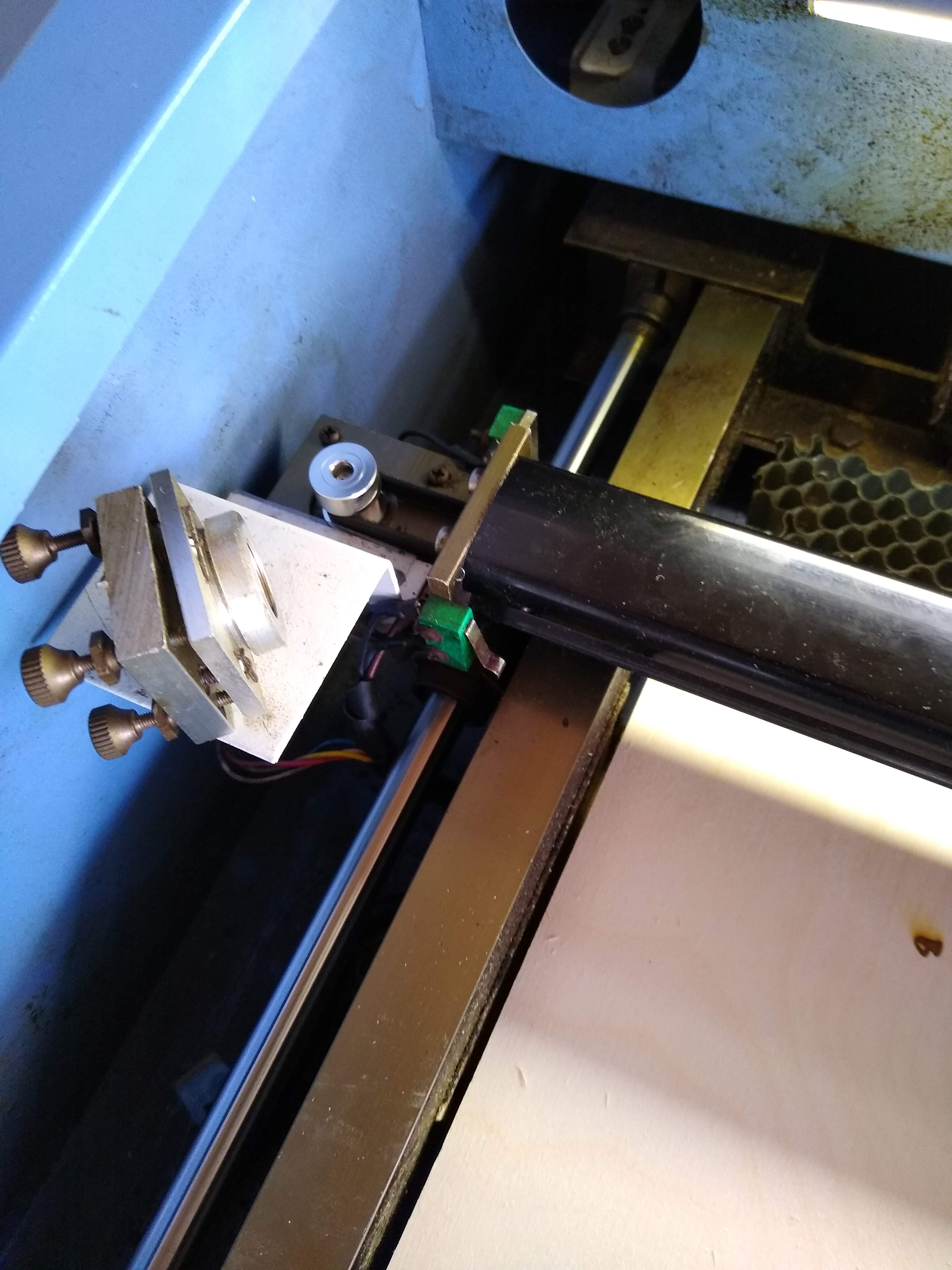

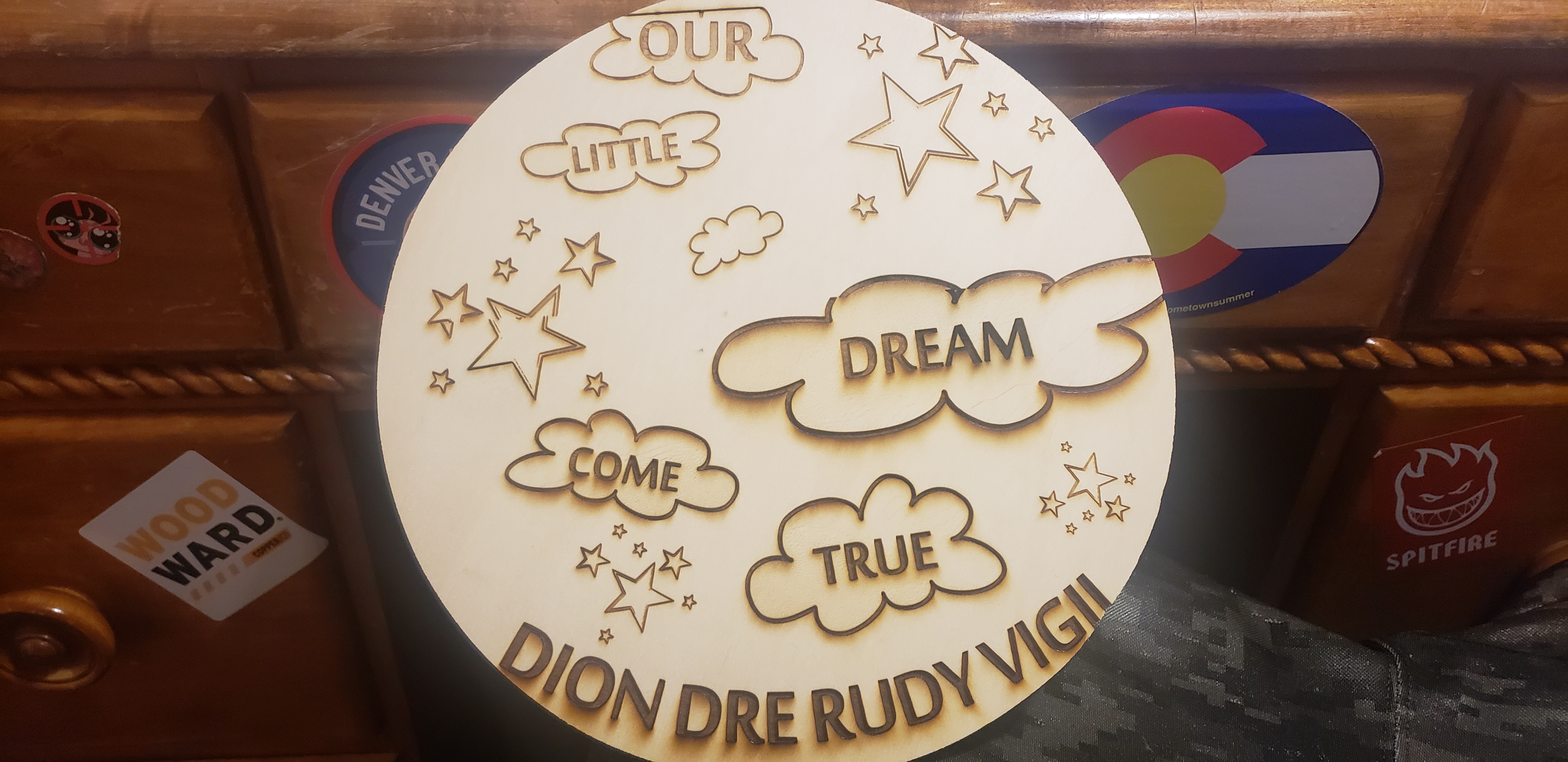

So I have a typical low end K40 and have done a few upgrades such as better mirrors, smoke assist, better water pump, better power cord, and an inline duct fan for exhaust. I had this issue previously and the culprit was losing steps because I was running too fast. I ran these at 150mm which I wouldn’t think is too fast, and also whenever I lose steps it seems to always be right around the half way point of a project. Any help would be greatly appreciated. Thanks

Hi. I have had this problem on and off for a while. I bought a new belt from Amazon and it came with 2 new drive gears for the stepper motor. I replaced the belt but problem still occurred. What I noticed was the drive gear had crud in the teeth. I decided to replace it with one of the new drive gears. Unfortunately the stock gear has been pressed on. So my dilemma was how to remove. I took a bicycle chain splitter and modded it. I removed the stock gear and fitted the new one. The new ones have an Allen key grub screw. What I noticed straight away was that the movement left to right was so smooth. It seems to have cured my problem. If you can’t replace the gear try cleaning it out.
