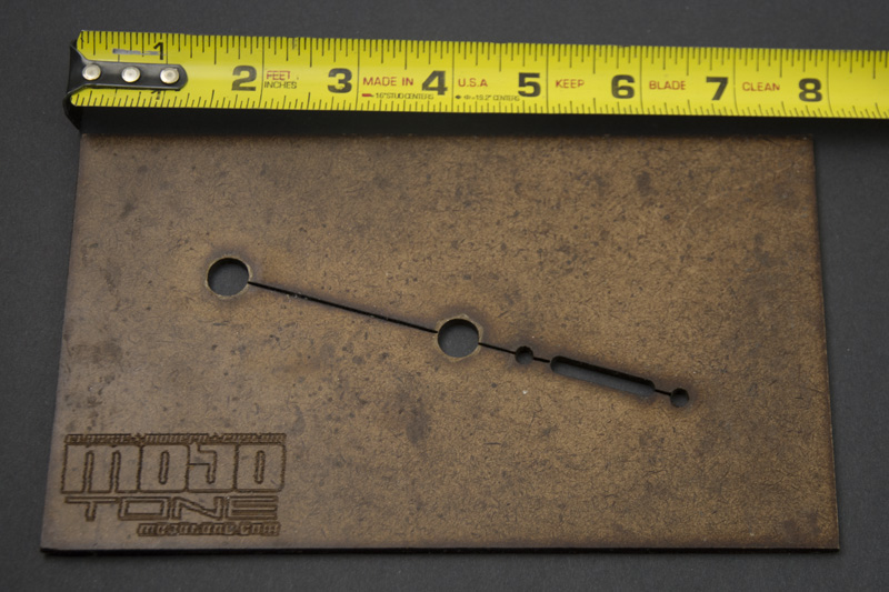

Do I need a 60w laser to cut 3mm masonite/hardboard?
A k40 should cut it if correctly aligned
I’m doing it. It’s pretty much all I do. I use 40w. I’m still working on alignment too. You NEED air assist if you want to do it right. And a better vent fan.
I’ve already ordered a 60w machine that has a wing that sticks out 17 inches. Are you doing the cutting at full power?
Nope 12.5mms/10ma with 4 passes. But I can do it in two in 5mms.

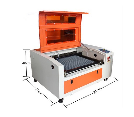

I bought this. $880 for a 60w
That includes shipping. I don’t know anything about using it. I hoping I’ll get enough help, on this site to make it work
