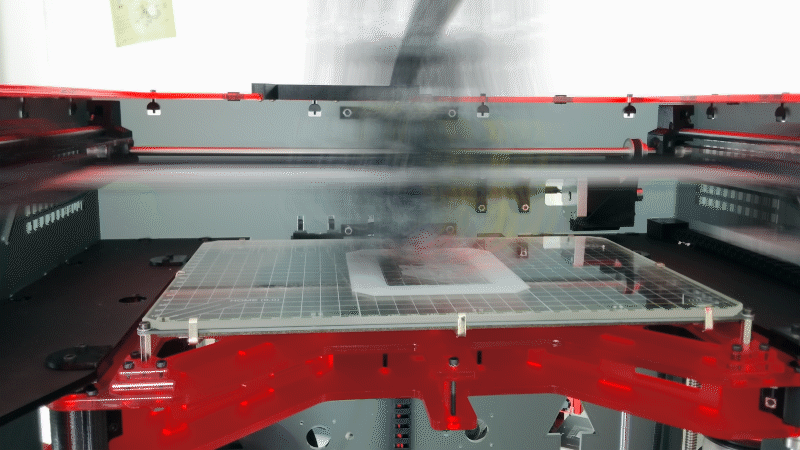

Take a look at the top ends of the front z-rods - they do flex inwards quite a bit as the bed moves down. The print still turned out perfectly, though!

Nice print. Watching that flex suggests to me that somehow the frame (or something) is pushing inward on the rods at the top. Which might make for a nice preload since it’s pretty clearly symmetrical :slight_smile:
Or the tripod crept a little.
Could be autofocus distorting the image as the platform rises.
Are they 8mm? They should have gone with something more rigid like 12. That way you wouldn’t have that issue.
Is the bed material glass?
8mm rods, but if you look closely it isn’t the rod bending - its the whole frame. It isn’t causing problems, but he can resolve it by tweaking the position of the tops of those rod holders. I left mine slightly loose, ran the bed up and down then tightened them. As a result they move themselves into the correct position.

it looks to me like the rods are set either narrow at the top or wide at the bottom. Or maybe both.

I’m still not seeing this sort of movement with my frame - I don’t have any of the new modifications and I still have the older un-ground smooth rods.
The main difference, as I mentioned before is that my frame is glued on the middle side braces (plates for the tops of the rods). But I’m not convinced that’s making is much stronger.
I would say this is still due to misalignment of the bearing mounts on the bed and vertical rods. That’s all possible to correct and get vertically straight. Also make sure you do the Z axis motor alignment - rammed all the way down then tighten up the Z motor bolts - you should get vertical alignment as long as the flexi-couplers are also installed correctly and everything in level.
