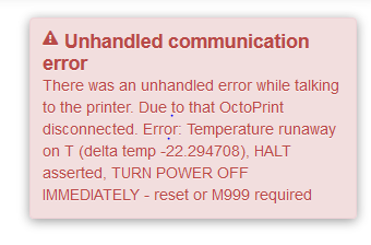

Well, a minute or so into the print, the Octoprint interface came up and told me I was having a T heater runaway, disconnect and reset, etc. Well, you know I did what I was told, and then went back through all my connections, tested every wire, and finally tried again, only to have the message reappear. Man, I was mad at myself for making any changes, so I went upstairs and watched some TV with my wife.
Now you get to laugh with me. I went back to the basement and spent some
time thinking through the process, and realize that the temp. change came after about 3-4 layers, LOL. The fan was turning on about then, and cooling down the extruder, while I was trying to print the duct to avoid that problem.LOL! Now I re-sliced the part WITHOUT the automated cooling and am printing away!
