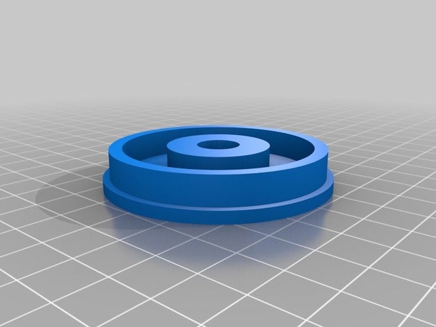

I take it you mean bearings to roll the spool on (cradle style) or do you mean to center it on a spooler rod? Either way I don’t use bearings. I just use printed adapter hubs to go from the spool reel diameter to the spooler rod diameter. Typically 52mm to 8mm.
