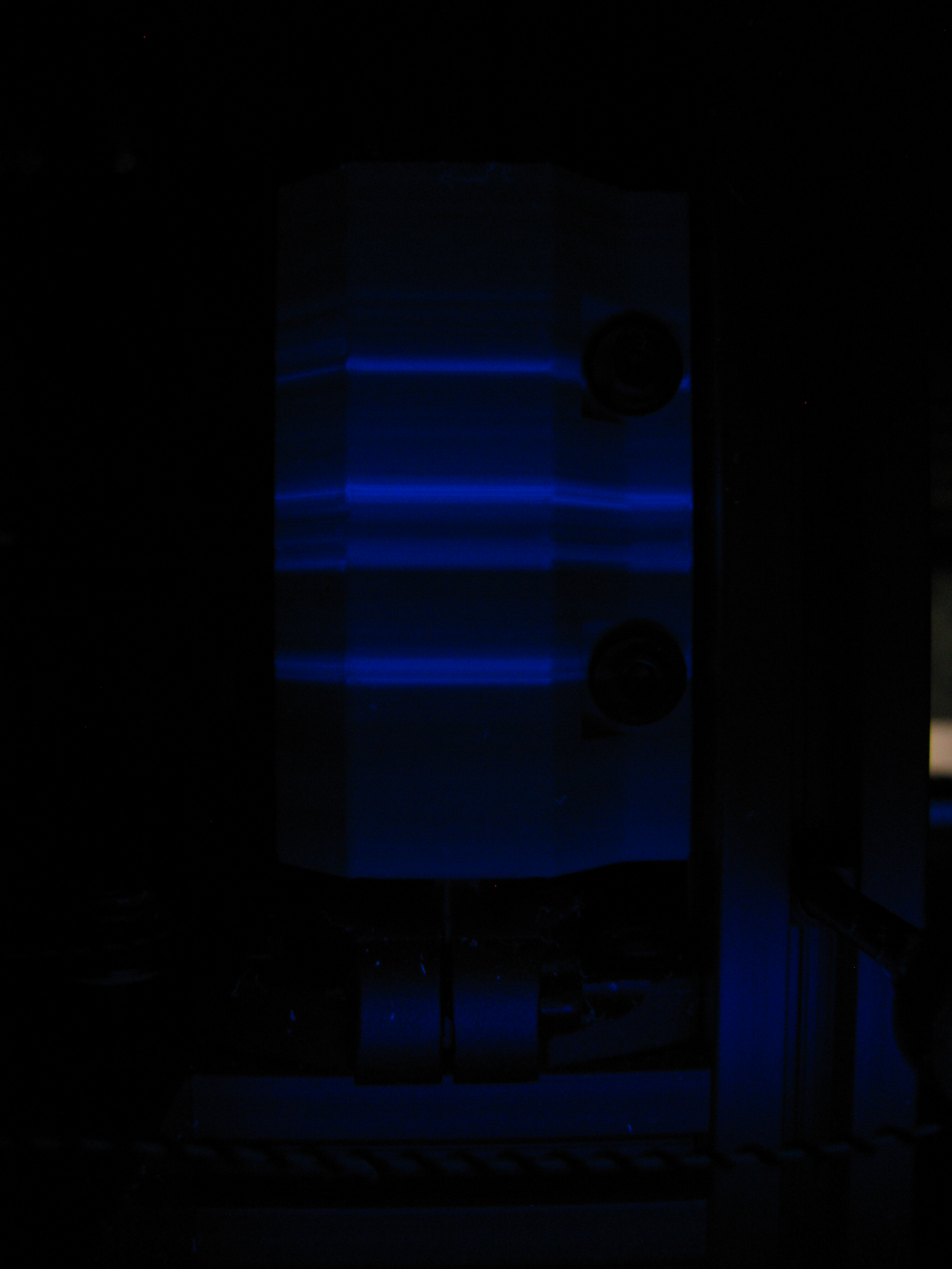

This is a photo under blacklight of an opaque white PLA printed part. Some layers glow under blacklight, some do not. It’s hard to photograph but the streaks of fluorescent material are really obvious in person.
UV-fluorescent pigments are pretty common for “neon” colors and super-high-brightness whites, but the concern here is that the UV-sensitivity of the pigment is very inconsistent within a single spool. What I suspect is that some recycled white plastic was added into the pellet feed. It may or may not have been PLA. It may or may not contain toxic chemicals. Without paying to send it to a lab, there’s really no way to know.
I don’t recall the brand used here – I printed these over a year ago and only noticed the fluorescent streaks recently. I don’t buy really cheap stuff though, I’m sure it was a ~$30/kg spool.
Dark colors like black are particularly bad for unscrupulous suppliers blending in random crud and industrial ash as fillers. Some colors can contain colorful-and-unpleasant heavy-metal pigments that are banned in the EU and US. (See thread: https://groups.google.com/d/msg/deltabot/pF3b0B11Mds/46BNXgNuAwAJ https://groups.google.com/d/msg/deltabot/pF3b0B11Mds/m7gFKC-jAwAJ)
Even if your filament vendor is reputable and perfectly trustworthy, their sub-suppliers may not be. It’s quite hard to keep junk out of the entire supply chain without rigorous lab testing or very cautious US/EU-only sourcing.
I’m a chemical engineer with professional background in materials safety and chemical exposure hazards. I also have a 7 month old son who likes to chew on plastic. And I’ve decided that Taulman nylon and a few other natural/clear materials from US/EU manufacturers are about the only filaments I’m comfortable with for making toys or food contact items for my family. I’m NOT worried about nanoparticle emissions – but I am worried about lead and cadmium and strontium in the stuff I give to my kid.
