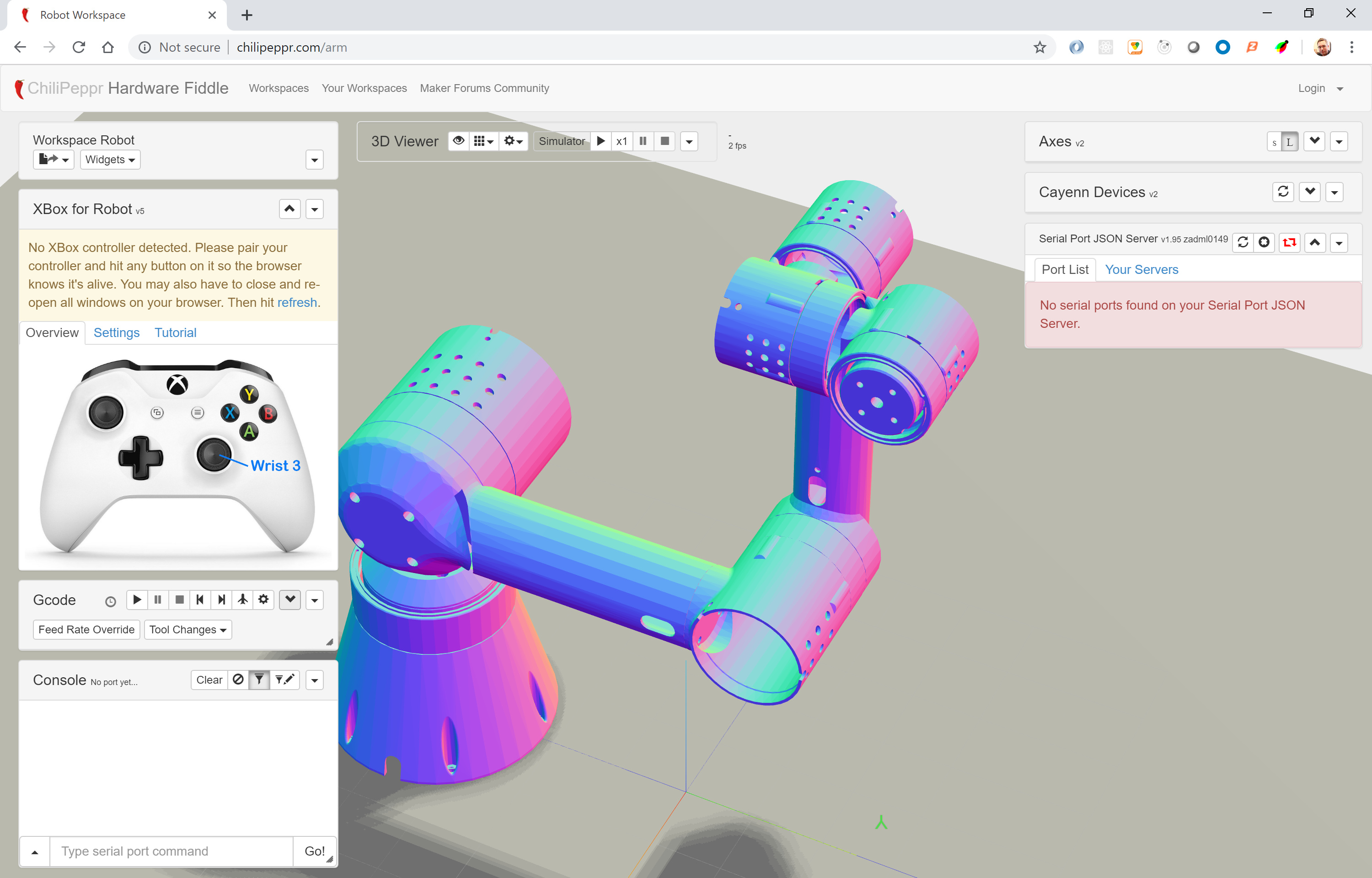

Doing each widget as its own Github project was a bit of a risk. It can make doing cross-widget updates like removing the Cloud9 link somewhat hard, but the distributed approach still has big advantages when it comes to creating new workspaces where you only want pieces of others. Take http://chilipeppr.com/arm for example which is a very recent new workspace with lots of updates. It uses the Gcode sender from the TinyG workspace straight up, but the Axes and Xbox widget are derivations of the TinyG version of the widget.
