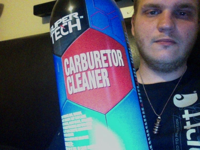

you can also try carberetor cleaner on PLA to make it flexible
Just something i found on thingiverse.
(I didn’t test it because i’m still saving money for my first 3d printer)

@Frank_Opmeer thanks for that ! Although I doubt i will try that one, as I am not really equipped to handle chemicals safely at home (small kid).
