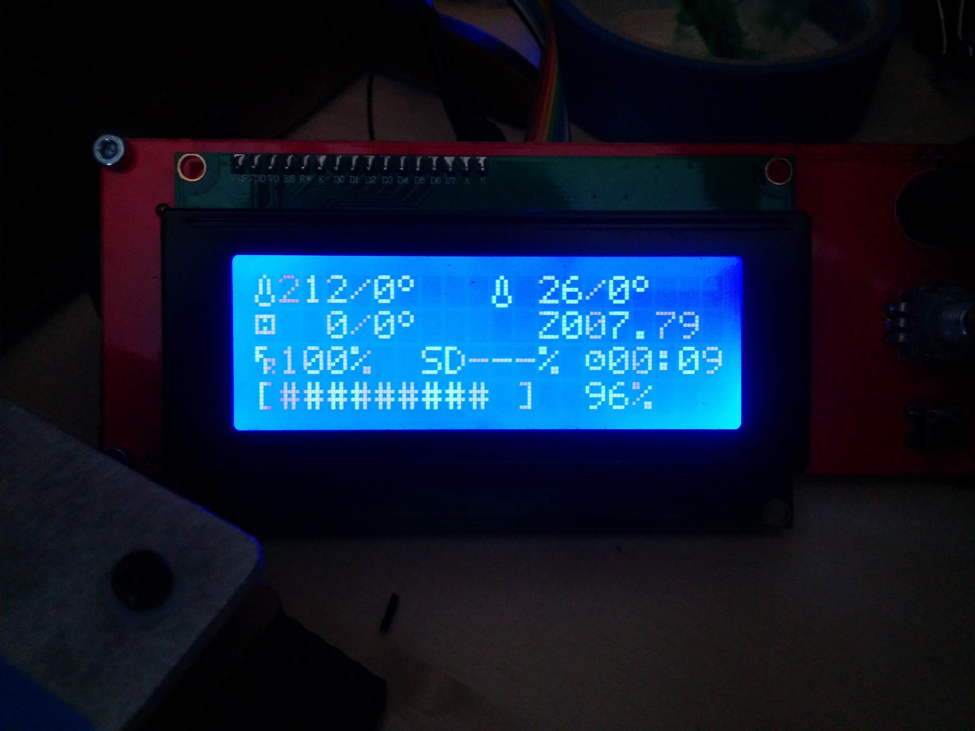

Does anybody know how to add a % complete message on a rerapdiscount lcd? I run Octoprint through a raspberry pi B+ and still have the rerapdiscount lcd hooked up. It would be nice to be able to see how much of the print has been completed on the LCD

@Rien_Stouten your answer is not really an answer to the question of @nick_durrett though. Whether he runs Marlin or Repetier, both will not be able to display completion percentage of a job streamed to the printer via USB. That’s like saying “Buy a Subaru” when someone asks how to pair his phone to his car’s stereo’s Bluetooth.
@nick_durrett look into the M117 command and http://docs.octoprint.org/en/master/plugins/mixins.html#progressplugin - you’ll need a (very simple) plugin for that.
