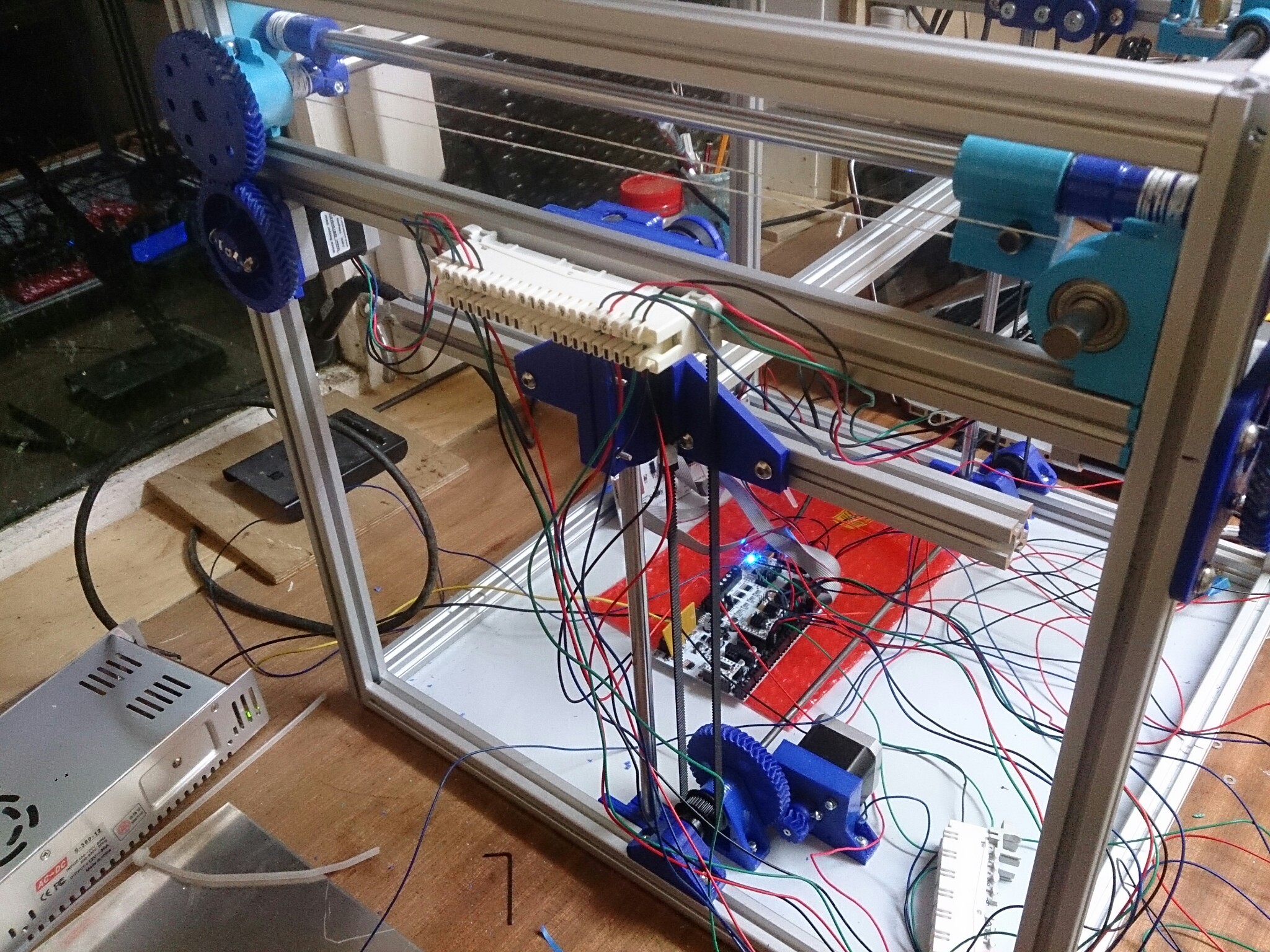

Does anyone else use Krone blocks as a means of connecting wiring together?
Does anyone else use Krone blocks as a means of connecting wiring together? If you don’t know what a Krone block is, it’s the white thing with all the wires hanging off it in the picture.

Yeah, I use those too for things that get disconnected regularly. The Krone blocks are useful as you just use a punch down tool to terminate a cable and that means there’s no wire stripping or fiddly screwdriver action. You can also ‘double punch’ 2 wires onto the same terminal meaning you can then daisy chain a single 12v feed for instance. I assume I can’t be the first person to have thought of using them…

The blocks aren’t self cutting but the tool you use has a little pair of snips on the end. All clever German engineering btw. You can buy 'clone ’ blocks and the Krone tool from Aliexpress for not much.

I use the same blocks as @ThantiK . The first time I built my printer I spent a lot of time crimping ends and tying the wire up nice, but re-doing all that with every modification got old, so now I don’t get much fancier than zip ties :slight_smile:

@Tim_Rastall I’ve been meaning to try them out since I am planning to rewire most of my cabling with CAT5-cabling.

These seem to resemble telephone punch down blocks. I think punchdowns are nice for signaling applications with solid wires, but not quite so nice with stranded. And, they’re generally not meant for high currents.
@Joseph_Chiu yeah, I had my doubts but telephony is only one several applications for LSA-PLUS. They are perfectly serviceable for steppers, ends tops and thermistors.
