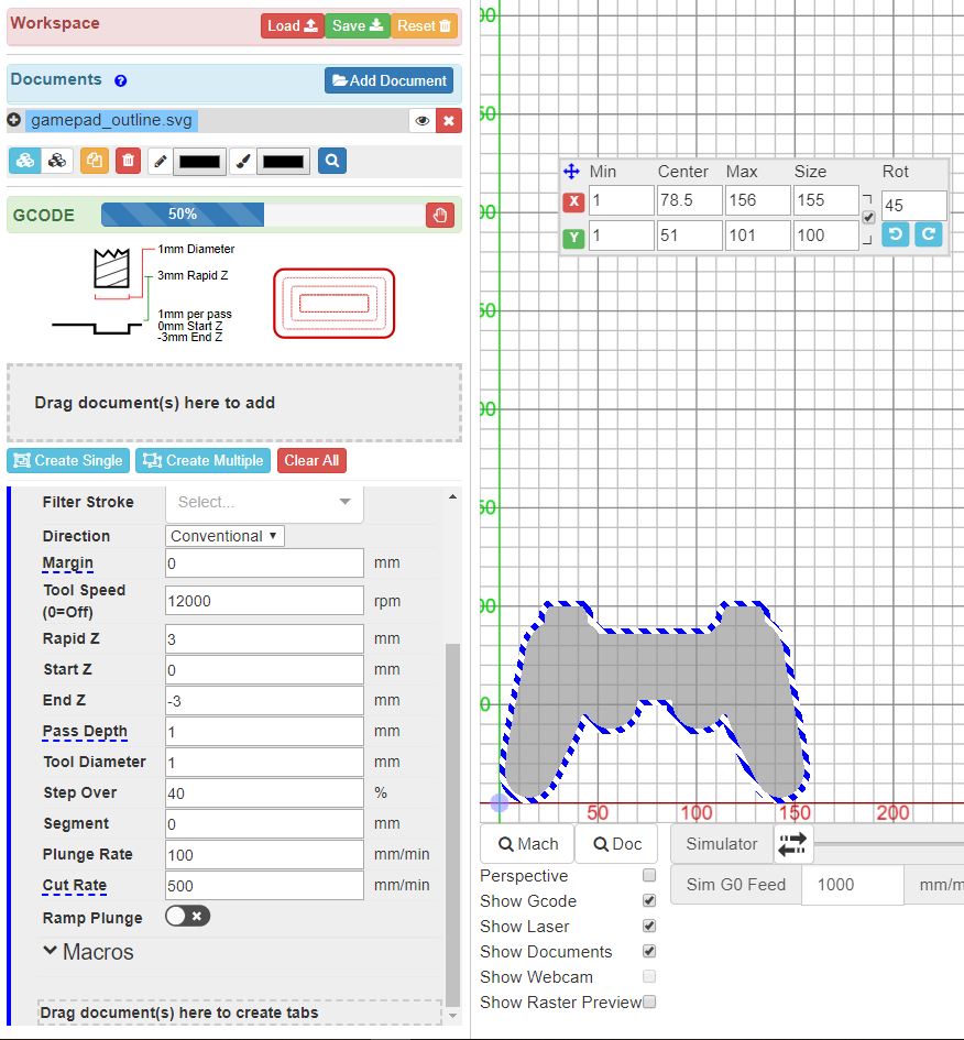

Does anyone got an idea why Laserweb is stuck at 50% when processing my quite simple SVG file? I’m trying to do a Mill Cut on it but it always stops at 50%. A laser cut on the same SVG file works without issues.

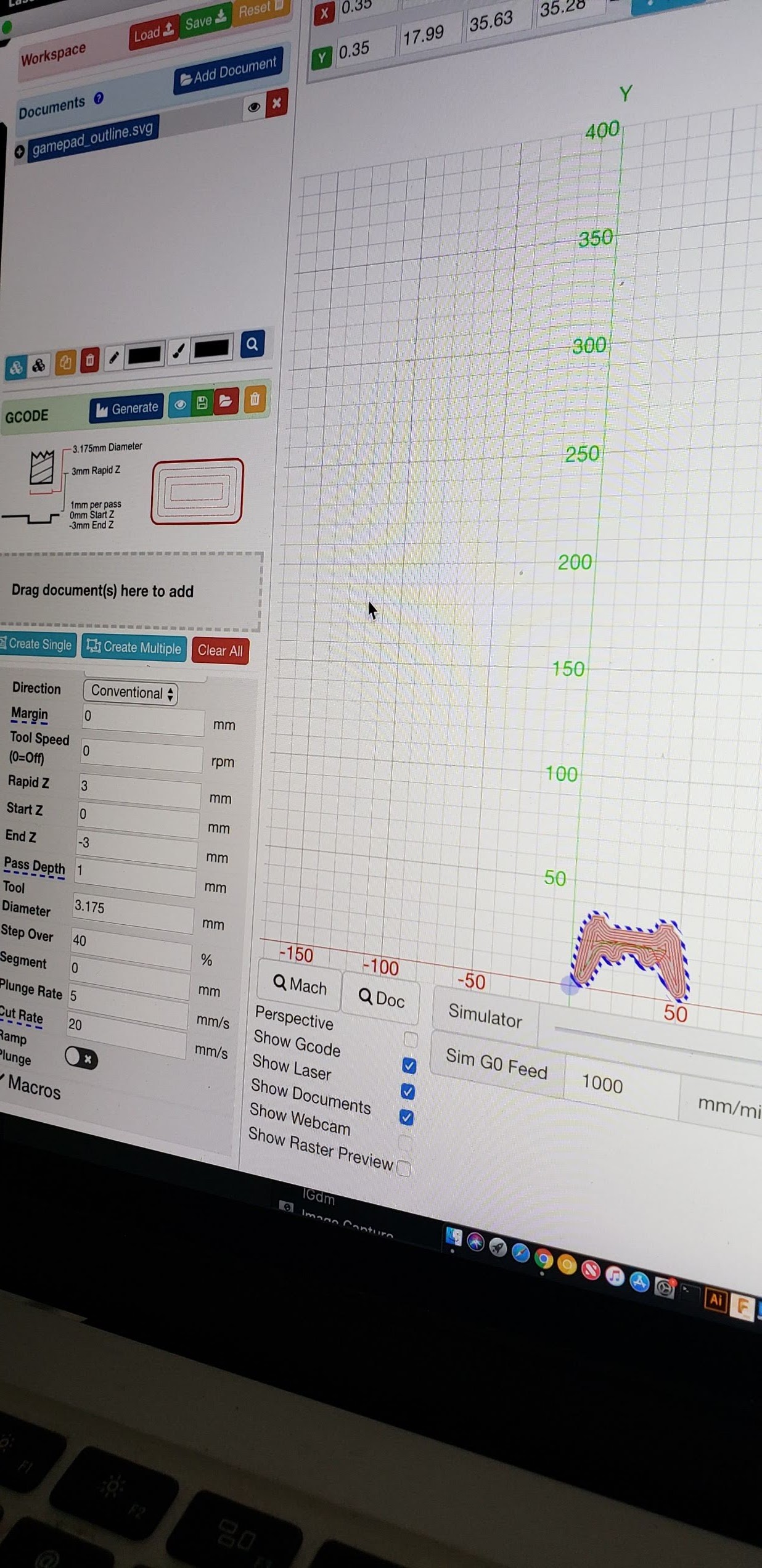

I just tried your file and could generate in milliseconds
@Ariel_Yahni_UniKpty Sorry, I’ve meant “Mill Pocket” operation!
@Michael_Zeile it works for me
@Ariel_Yahni_UniKpty That’s really strange. I’m using 4.0.990 / 4.0.301 and I can only “Mill Cut” this shape but not “Mill Outside” or “Mill Inside”. I’ve also tried it here online ( https://laserweb.github.io/LaserWeb4/ ) and it also gets stuck at 50% during the generation process. In addition I now inbetween had several other shapes which showed the same problem. I always made sure it’s a closed path in Inkscape. Did you do anything to the provided file before it worked for you? Thanks you!
Anyone can help me? I’ve the same problem with lots of other shapes as well. In between I’ve tried it with three different PCs and even with Edge (aww). The only thing I figured out now is that the gcode generation finishes when i use a larger tool:
Toolsize=10mm -> Completed after 15 seconds
Toolsize=8mm -> Completed after ~30 seconds
Toolsize=6mm -> Waited 10 minutes then cancelled it

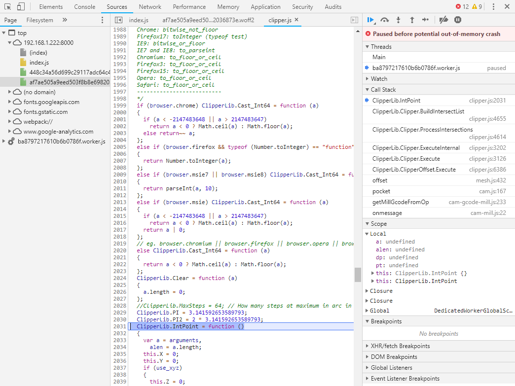

Enabled debug logging and observed the Chrome console with the following result. My Windows PC memory usage is at 50% (8 GB of 16 GB used) while running tons of other stuff. Chrome itself is at 1175 MB. The shape I’m using is really not quite complex. Problem starts to appear with a tool size of 7mm while 8mm is still processed okay.

Im sorry you are having a hard time getting this to work but its puzzling to me how fast it work on my side in windows and osx. FYI i prepare my svg in illustrator with no issues, also i use sketchup, rhino, fusion 360 for dxf files
