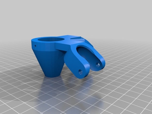

I have used a 3D printed air assist nozzle that had dual mounts built in for 12mm line lasers. It worked great for determining the laser beam location, and of course depth does not matter when using dual lasers. I have been modifying the stl file to work with a LightObjects air assist head just keeping the laser mount portion of the stl and getting rid of the air assist portion.
That is the one I am attempting to modify.
