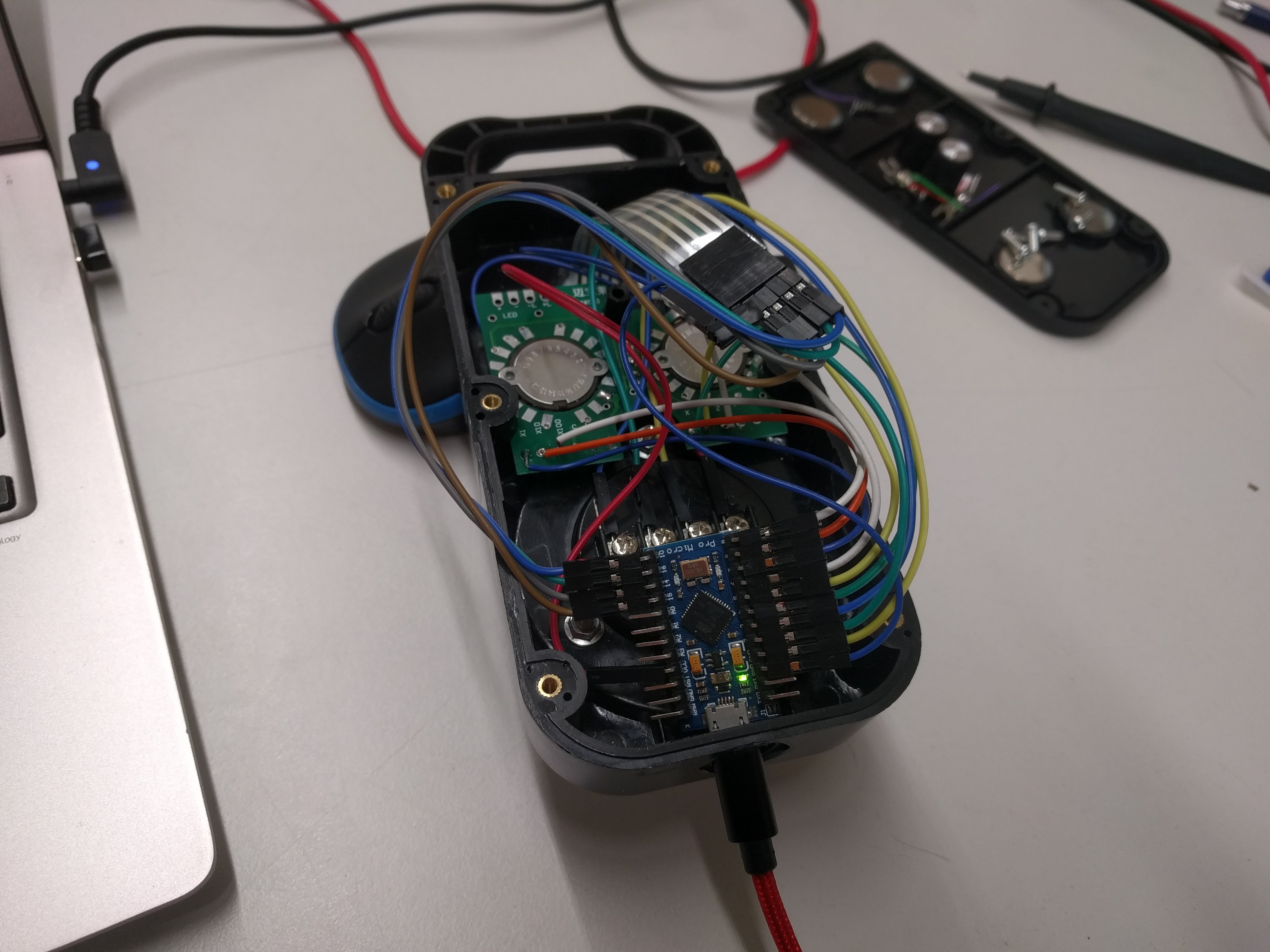

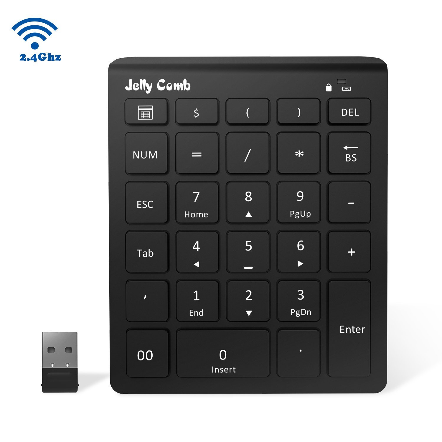

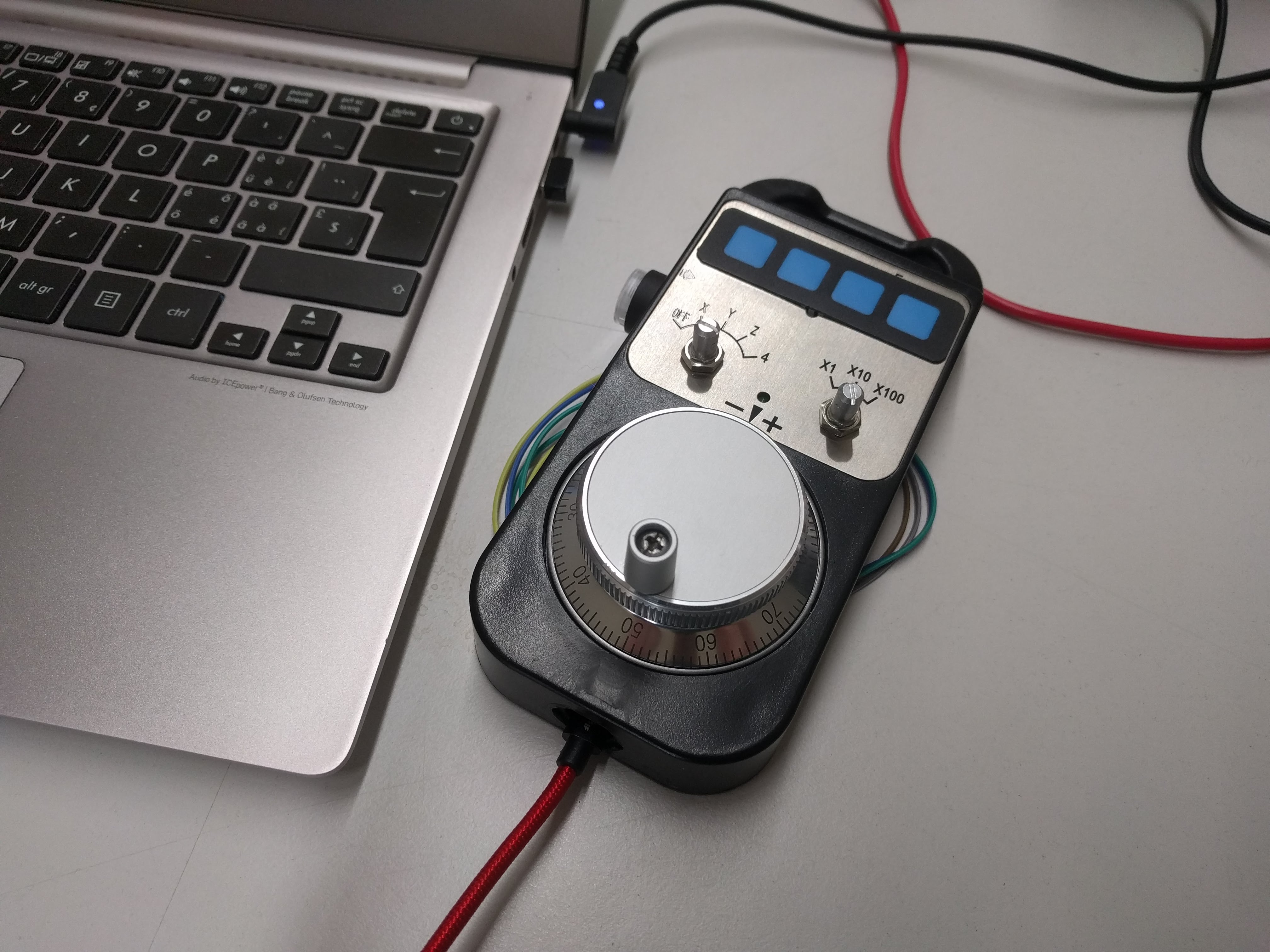

I found that a simple USB Keypad and http://HIDMacros.eu you can create a really cheap either wired or wireless pendant. http://HIDMacros.eu lets you address keyboards separately. So, keys don’t conflict with regular keyboard commands. I got one today and have been using it on UGS. UGS is okay but is very limited when it comes to file sizes and obviously there is no direct SVG support. I’d really like to use LaserWeb for everything. I have it running my Laser CNC but I would love to do more with my router.

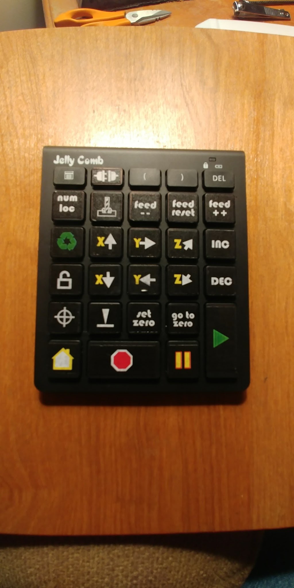

Ok, I got my wireless pendant programmed up. Currently only the few keymaps in Laserweb work. I have made all of the same keymaps in UGS. All of the buttons work in UGS. It is a beautiful thing.
The labels are currently printed with a Dymo labler. I made custom icons in Inkscape and imported as images. I will be doing them in color using color laser printer. I will have black backgrounds. I will print the backside with all black so the actual button letters don’t show through. Then i will use clear satin spray paint on the top and spray adhesive on the back.
The labels I created with Inkscape. I mocked up the keyboard with labels. I printed the front in color on a color laser and the backside in solid black. I wouldn’t try with an inkjet. You could also slowly with very light coats spray paint the back black. The goal is to keep the key numbers from showing through. It also helps to make the labels more durable.
The front, I spray painted clear satin, again very light coats. Too heavy on the first few and you lose the white. Ask me how I know. Lots of coats, again for durability. Then I sprayed the back with two coats of Gorilla spray adhesive. I let that dry tacky, 2-3 min and put wax paper on that. Next I cut out the keys and applied. Finally I lightly traced the edges with a sharpie to get rid of the white edges
The nice thing about using HIDMacros.eu is there are no limits to your layout. I only used the NUM LOCK version of keys because that is the default setting for the keypad. All of the keys are addressable both num lock and non. You could also use multiple keypads or keyboards. Each HID is addressed separately. I will be posting an Instructable.
