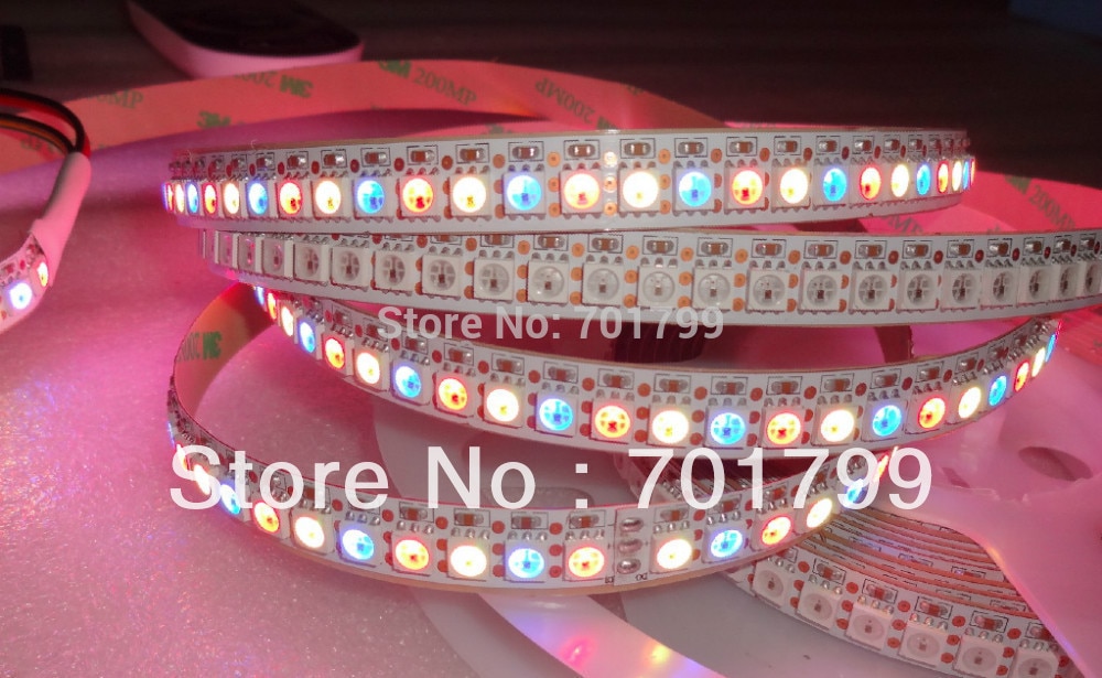

http://www.aliexpress.com/item/Fast-Shipping-1m-144-Pixels-M-WS2812B-Chip-White-PCB-WS2811-IC-Digital-RGB-LED-Strip/1357637826.html
I think aliexpress is actually the defacto market for a lot of us, but more specifically Ray Wu’s store: http://www.aliexpress.com/store/701799
