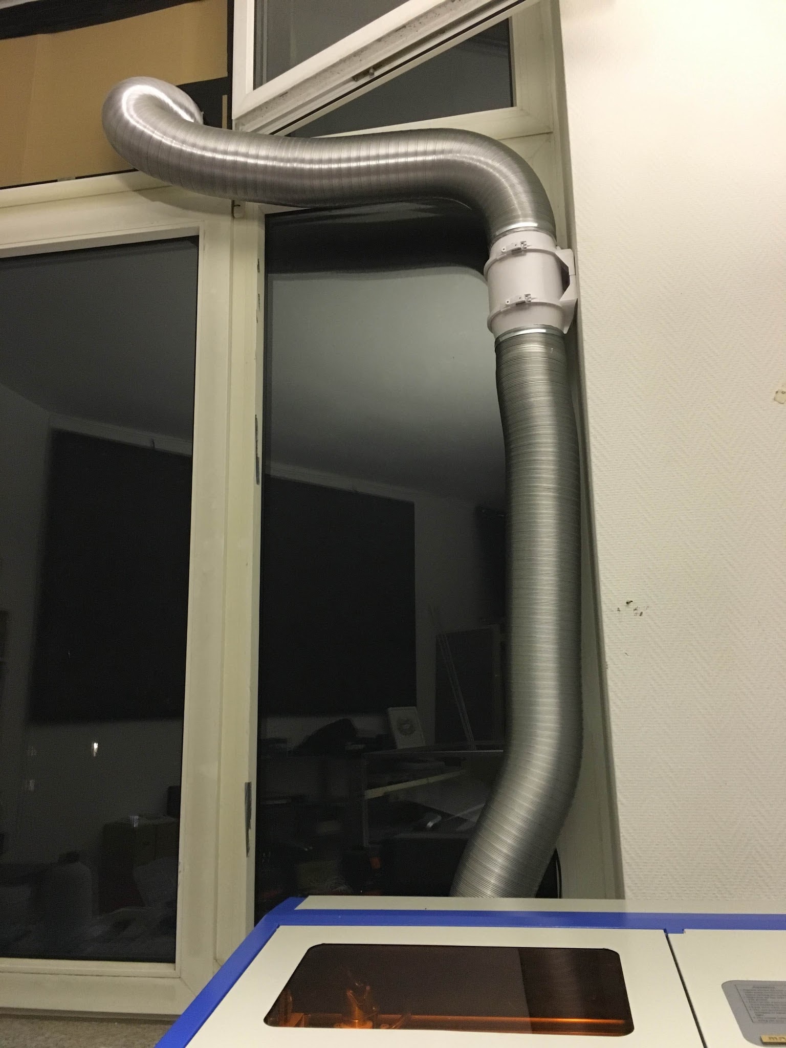

Does anyone have an exhaust fan recommendation for Europe? I tried a 125mm “mixed flow” fan but it’s not sufficient. I was looking at this 150mm or 200mm radial plastic fan. Any thoughts? Thanks. 150mm - 460 m³/h (272cfm) http://www.amazon.de/DALAP-Rohrventilator-dalap-Turbine-P-150mm/dp/B00JMB9H4S - 200mm - 780 m³/h (460cfm) http://www.amazon.de/DALAP-Rohrventilator-dalap-Turbine-P-200mm/dp/B00Y0BFHXU Photo is of my current setup with 125mm flex tubing

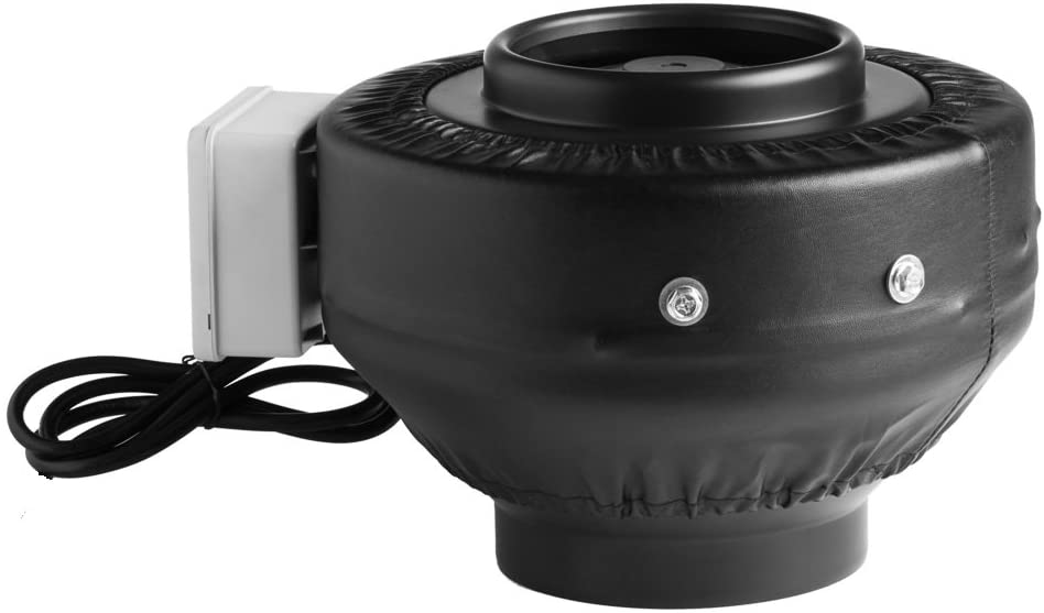

This is the one I got of amazon it works amazingly well. hardly any smell including when cutting Acrylic
Thanks, ordered!
