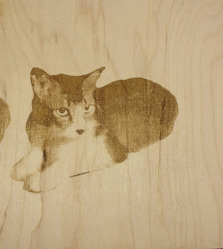

@Alex_Krause Wow, you really are a master
I tried that about 20 times & all I could get on the face was black. That is a spectacular result. I was under the impression that some images just won’t work, but obviously that is not the case. Cheers for proving that point to me
