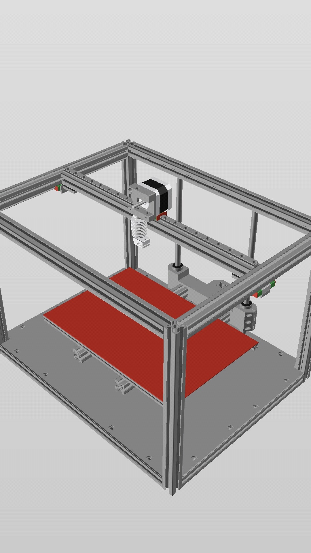

@Daniel_Stauffer , now I’m curious what you’re building if this machine is planning to be powered by 240V AC.
@Cruz_Monrreal_Mr_Cru ​ I am building a printer aimed at high temps for printing peek for instance. It will also have a large build volume of 200x300x200mm. I don’t want to use a large mk3 heatbed because it will take very long to heat the plate (one mounting plate and a detachable build plate). The only way I found to overcome this is to use an SSR and a 240V silicone heater.
Sounds great so far. I will give it a shot.
