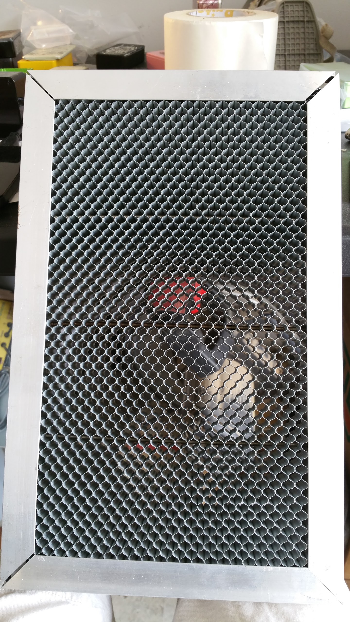

in the process of making my own adjustable z-height table… so far got the honeycomb surface… waiting on aluminum U-trims and time to start testing the design
