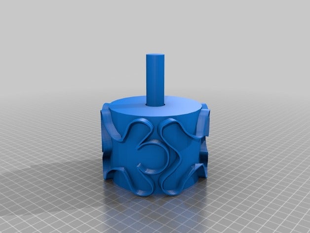

I thought there was a library for this on Thingiverse…but I can’t seem to find it. This thing wraps a “cookie cutter” around a cylinder…so it might be a good starting point.
Found it: http://www.thingiverse.com/thing:16193
