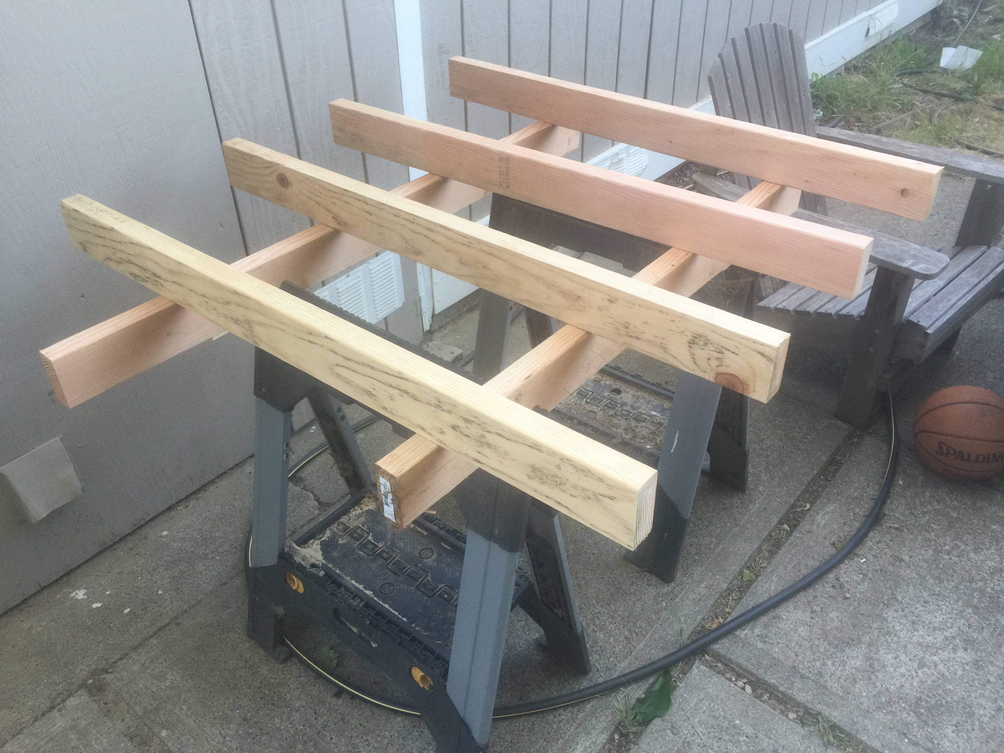

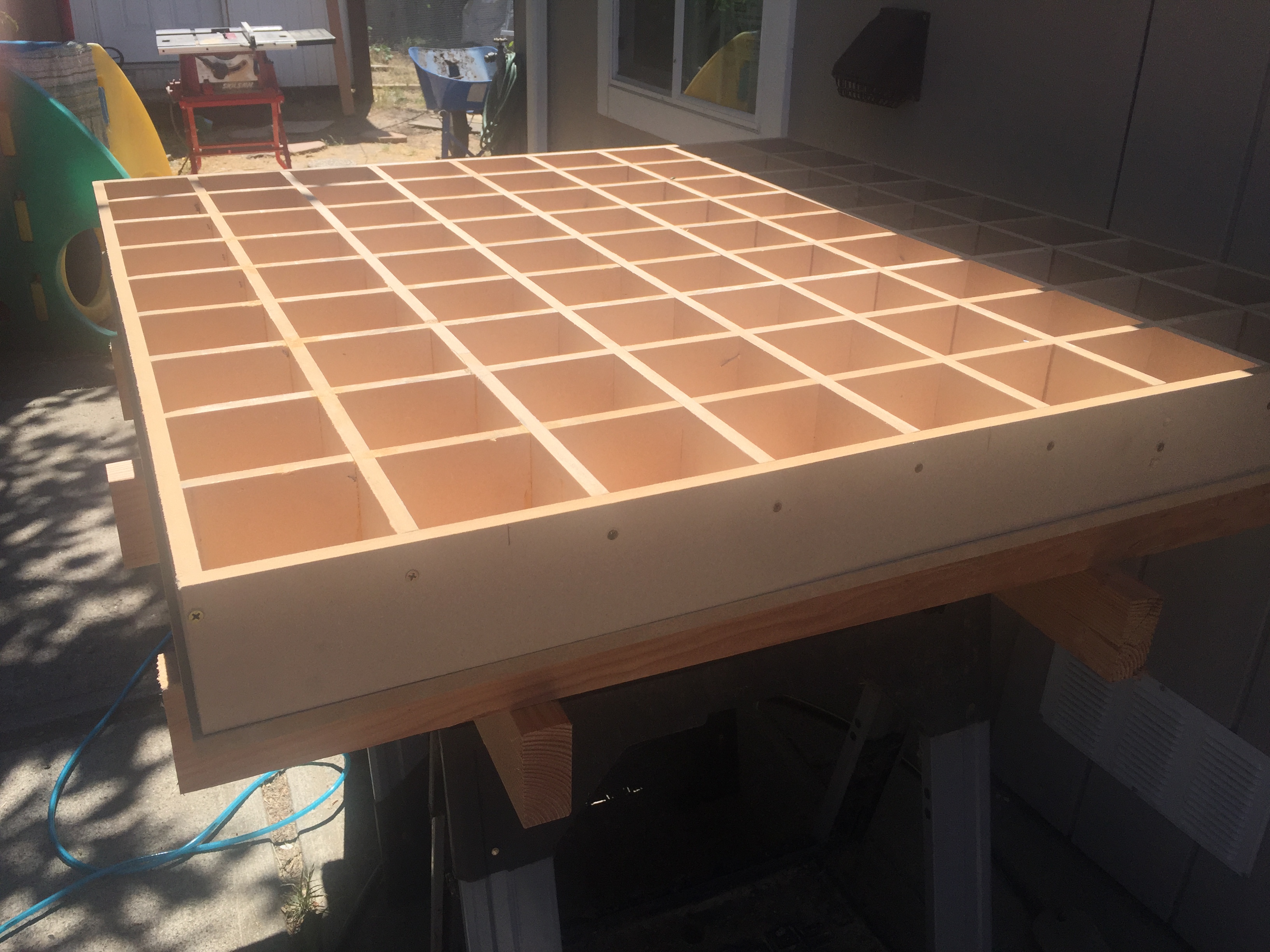

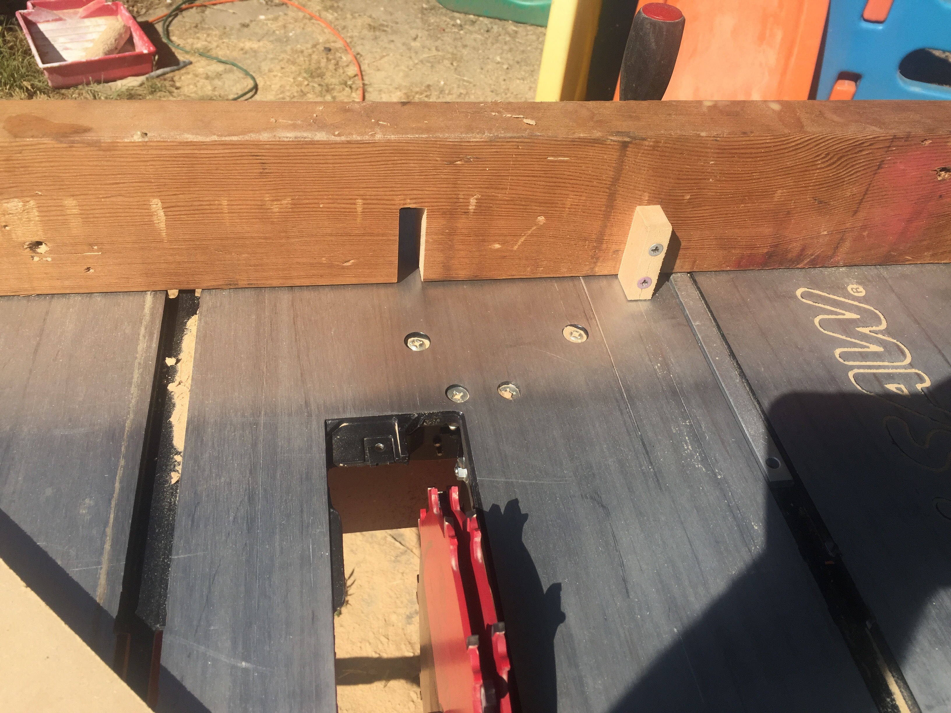

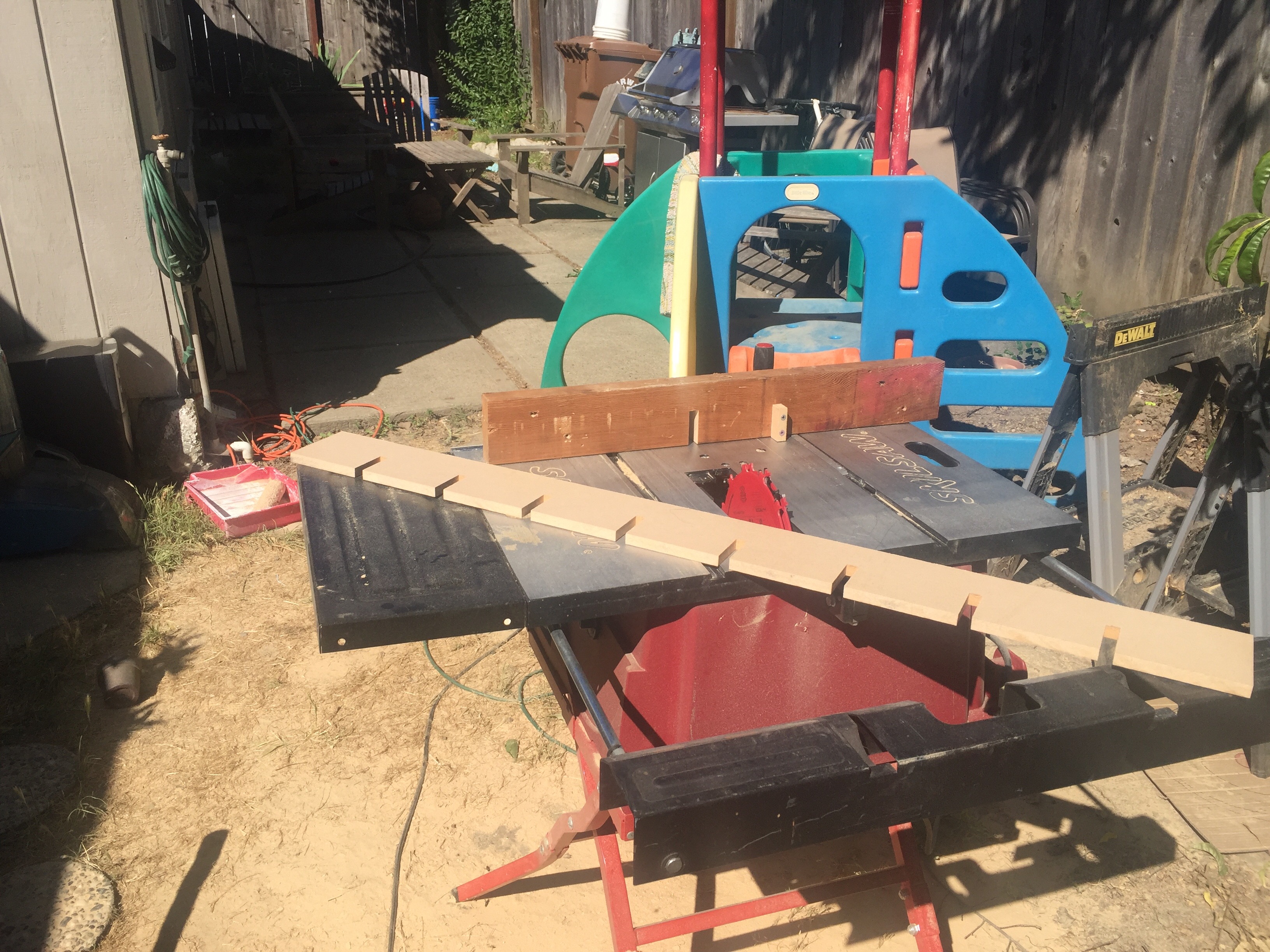

Torsion box nearly complete.

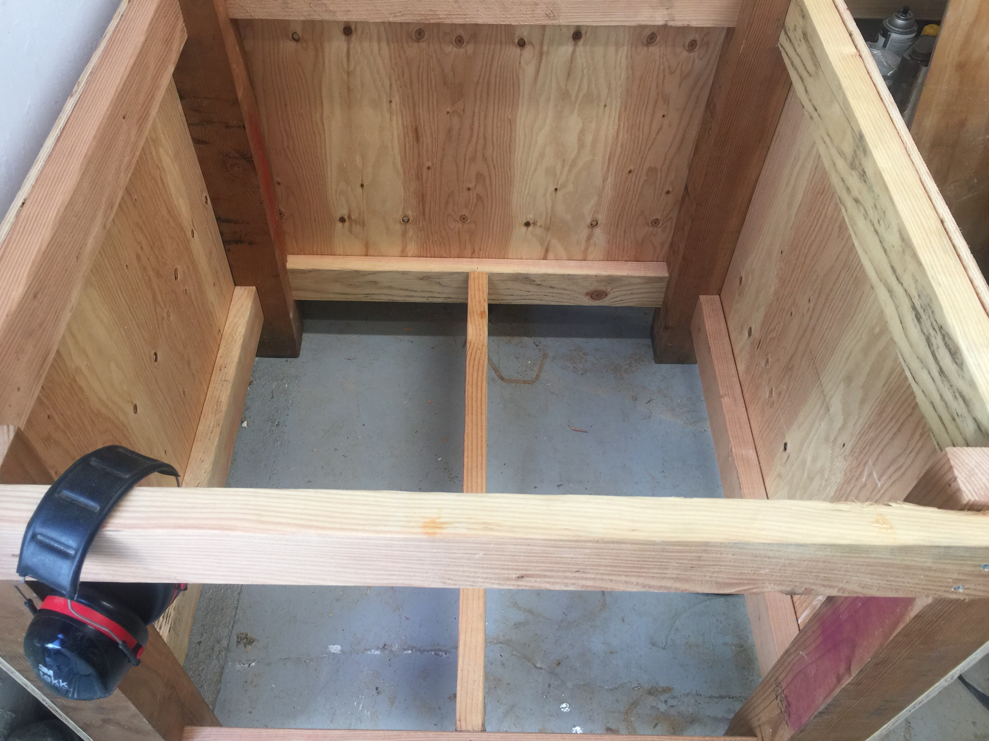

A simple 3’ pedestal.
The table is finished and the metal parts are on order. :slight_smile:
