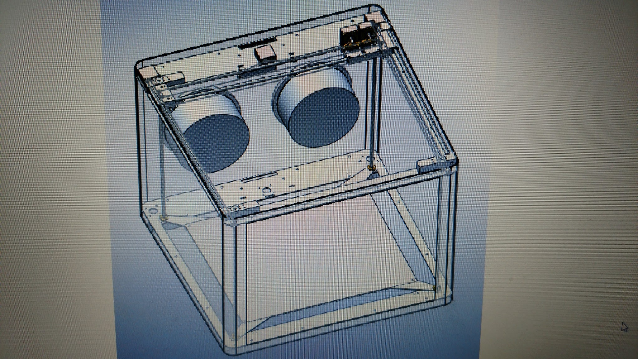

+Peter van der Walt I wish that I could build one right now. Just ran out of money trying to prototype a 434mm cubed duel print head build volume. Its a CoreXY/Hbot design. Heres a picture.

Interesting design @Alex_Hayden

@Ariel_Yahni_UniKpty thanks for taking a look. Besides interesting, what else do you think? I know it’s kind of hard to see all the details in the photo. But I would like to know what you have to say.
So this that you need its for that printer? I would really work on play maybe first until you are sure of the design. Whats important about a design like yours are the parts on the gantry and the way you will tension the belts plus Z axis should be held and secured from multiple side not cantilever style, specially on a large build plate
@Ariel_Yahni_UniKpty The bed is mounted between 4 speed screws in the corners. I think I have worked out a good way to tighten the belts. I am not sure about play in the gantry yet.
