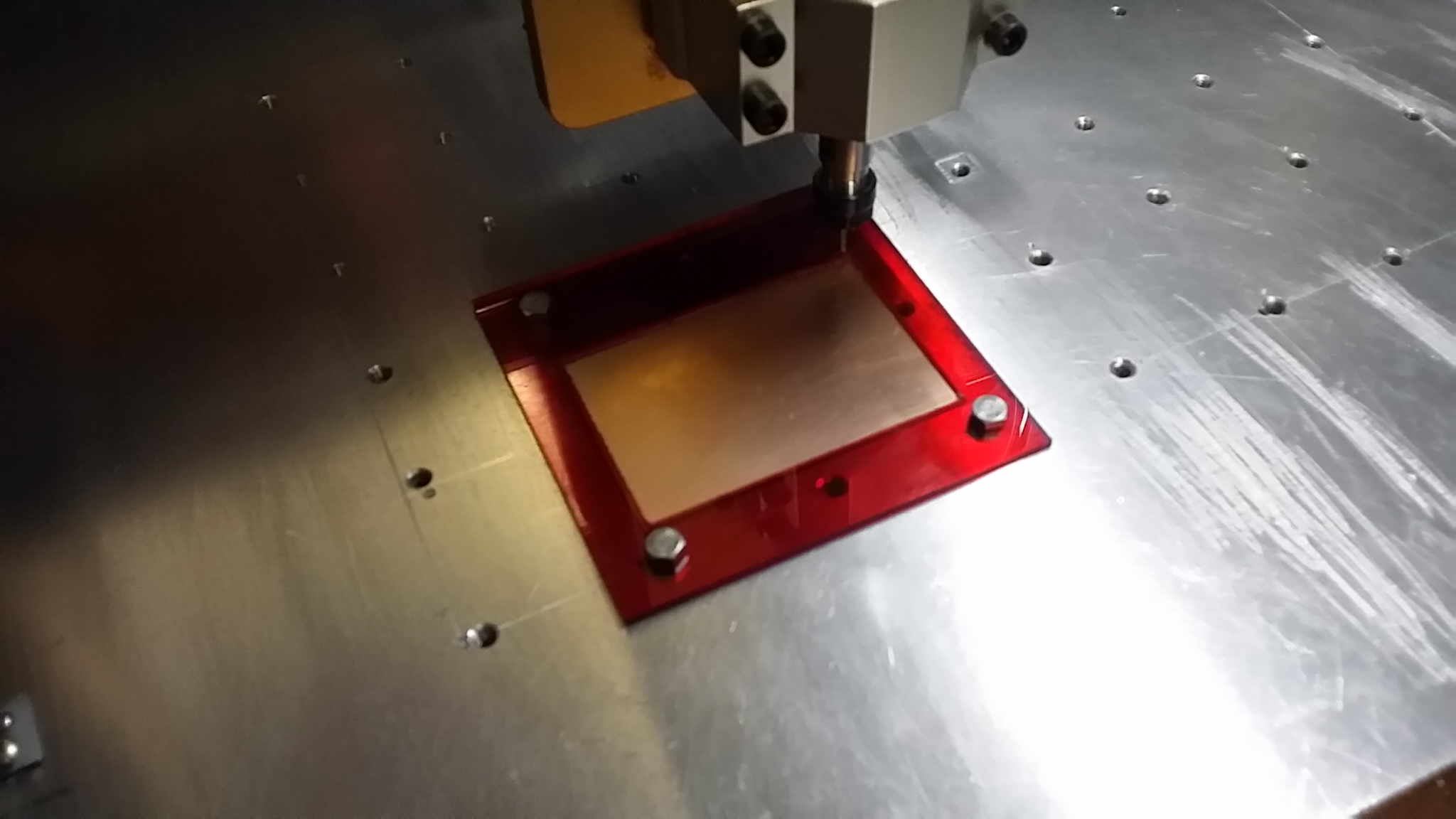

@Kyle_Kerr Thanks Kyle I watched the video with great interest. It appears that 3 Watts is more than adequate. The video has given me a few good ideas.I have a circuit board jig that will hold the PCB in a predefined position and I also have 3 watt Infrared Laser that might do better. Obviously I will have to PWM the Laser so I don,t burn the PCB.
@Robert_Ritchie How do you touch off X and Y with a laser? Like how do you get it to hit where you want it to hit?
@Paul_Frederick well my small laser has a home position and the PCB jig would have a set amount of offset to that. It will be a very interesting time over the next couple of months. You will be the first to see both my successes and failures right here.
@Robert_Ritchie I can see what you mean. But I can see that being tricky to setup. I just touch off about where I want stuff to happen. I’m usually not too finicky about alignment though. I usually have margin on work pieces. You know how it goes.
One could use a paper target a known distance from 0,0 of the board. I have seen a guy use paper targets to help him align his beam on his laser cutter.
