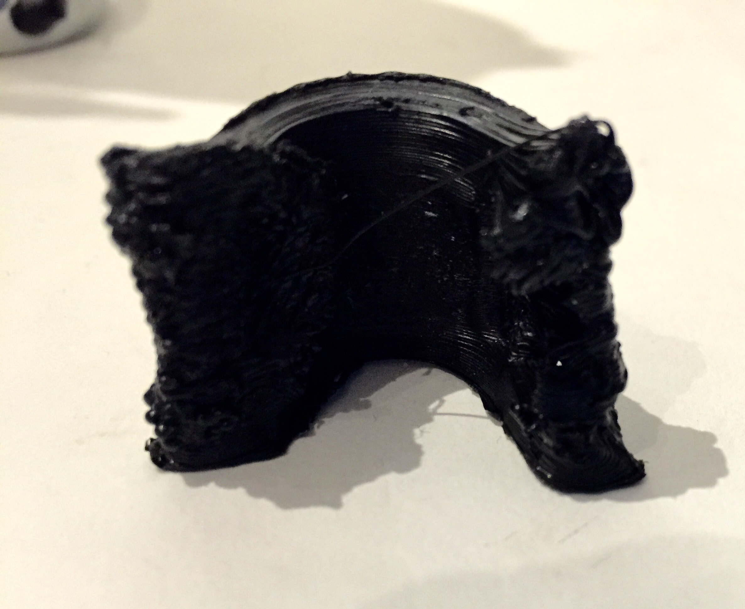

Does anyone here have experience with 3D Filkemp's Graphite Black PLA Blend?
Does anyone here have experience with 3D Filkemp’s Graphite Black PLA Blend? It’s as tough as nails but this first test print of a bearing clamp looks like it’s been thrown out of a fire!

Your speed is set to high ! try to print whit 20 - 30 mm/s

@Dennis_Vercauteren is it? Or is it a temperature thing? The same model with a different filament printed much better at the same speeds. How much of the problem is down to controlling viscosity not speed?
I am pretty sure it is.
The filament have to cool down before putting next layer on top.
So. I’ve printed some contructionprofiles (small long H shaped things) with a speed of 15mm/s
You can see clearly that the outside end of your parts are still melting. The middle is ok. The reason is that there is more time between the inner and the outer side of the part.

Speed reduced massively, temperature dropped too and it’s looking much better but still far from perfect, if it doesn’t print better in the morning with another 5 degree drop I’ll try ramping up cooling. I’d use my 12v ducted model airplane fan for extreme cooling but it screams, time to bring out the office fan again.
