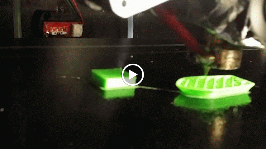

Does anyone know how to change the speed of the prime pillar in Simplify3d?
Does anyone know how to change the speed of the prime pillar in Simplify3d? Now every second layer is very slow.
