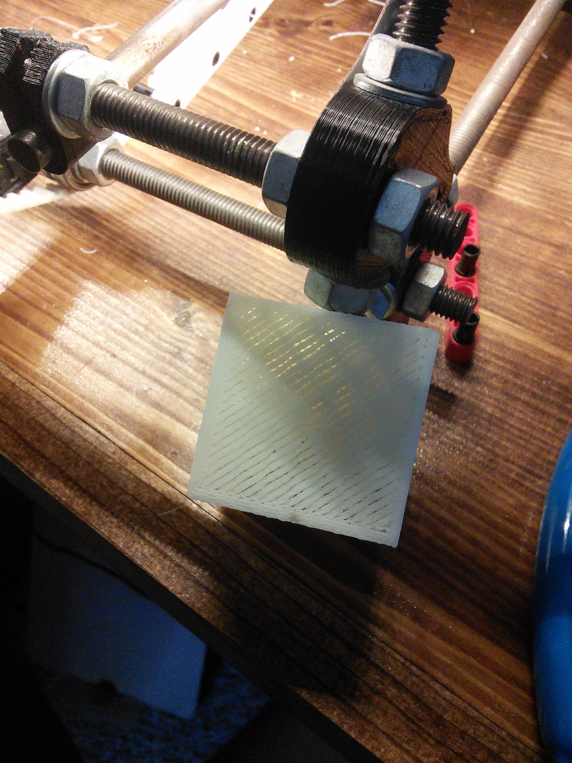

Does anyone know how to fix this
I have a prusa i2 with marlin and an e3d hotend with a .4 mm nozzle. I am using the latest version of slic3r
How well is your e-stepper calibrated?
Is that 1 base layer? Do consecutive layers yield similar results?
Generally solid layers do that but I have had prints without that problem and it confuses me
What layer thickness?
.2
Tell slic3r your nozzle is 0.37. I call it underclocking.
Have you calibrated your filament feed rate (e steps)?
Is it filament dependant? Might be slight differences in feed rate
Slic3r parameters setting problems.
Yet another vote for your e-steps being off…
I’m looking into it
It appears as if my esteps were off by fifteen or so. I’m printing the same cube now to see the results
Take a look on the extuder bolt. Probably it is not tight enough and it is not transmitting well the torque from the motor to the filament
Thanks! I got it fixed
Ethan, how you fixed the problem? I have a similar problem. Thanks
I lowered the nozzle to the bed and calibrated my e steps
Thanks for your answer
