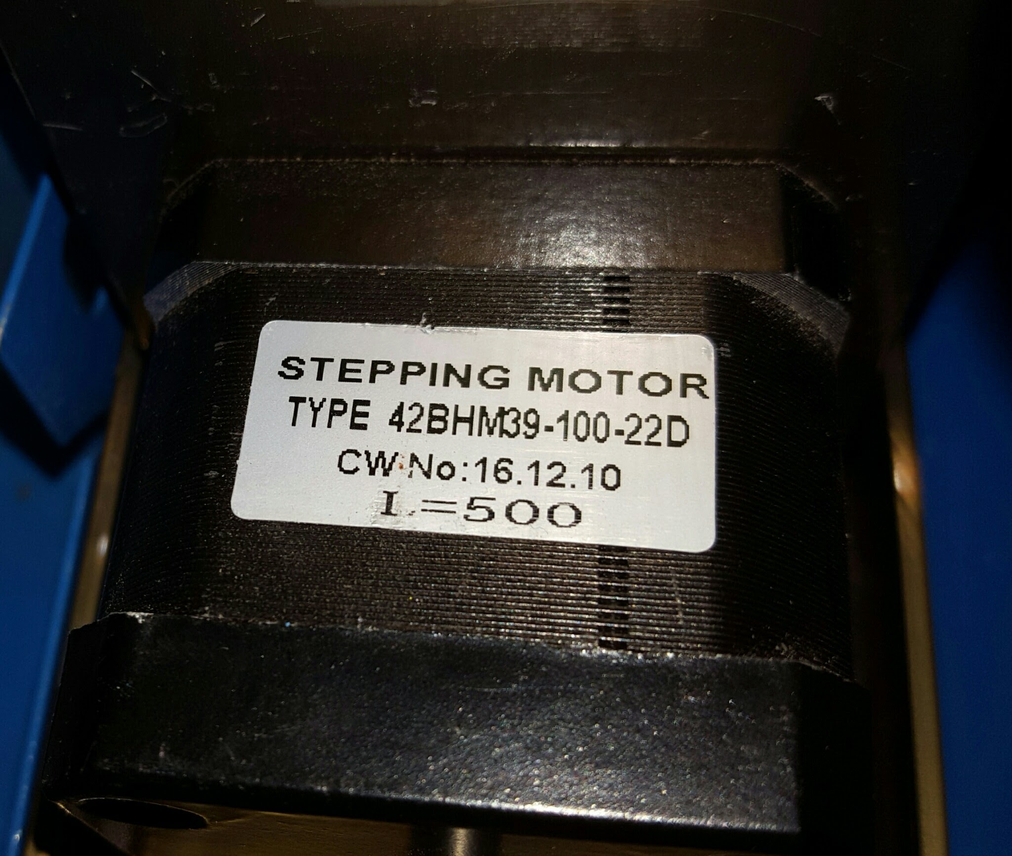

So, did anyone find a replacement for the Y axis stepper motor? Mine is labeled Type 42BHM39-100-22D.
Im attaching a picture. On the sticker, it says I=500. Is this possibly the current rating? 500ma?
I’m building a rotary, and i just dont want to fry the controller board. If the A4988 on the controller is regulated to =<500ma, I should be able to connect my 800ma max rated motor without hurting any thing.

I was not looking to replace my motor, I was attempting to establish the electrical specs of the existing one, so as not to damage the controller by attaching a rotary X axis. Turns out I did the math, and I used a motor that just exceeded 500ma current rating, maybe 600ma, and voltage was at least 12 or so, I think mine was rated at 48v. I didn’t care about torque because I’m driving a ~50:1 gear box.
Thanks @BeenThere_DoneThat , that is what I am trying to do too. I dont need to replace my Y-Axis motor, but I wanted to find one I can just plug into the board, by swapping the original plug. I’m trying to build a rotary axis and plan to just plug in a matching stepper to the Y-axis and then - hopefully - get the gearing right to have the rotation at something acceptable to engrave cylindrical things with… If yours just ‘plugs and plays’ without any issue, could you post what the part number is of the one you used? If not, thank you anyway, I can probably work with what you have already provided.
