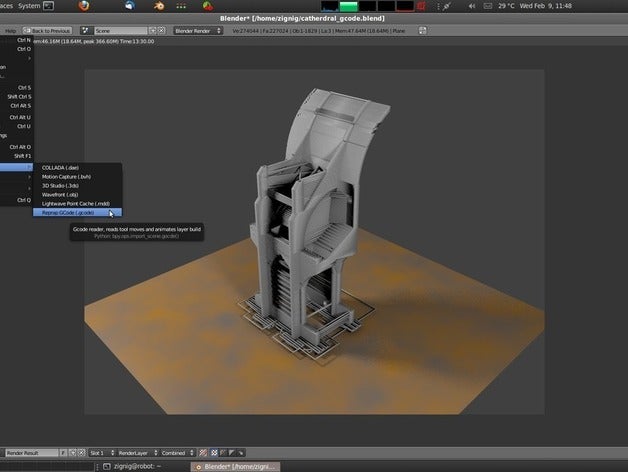

I’m not sure if this is what you need, but there is a Blender addon that allows you to import gcode, turning the extrude moves into mesh (or curve data displayed as tubes, I don’t remember, it’s been years since I’ve used it. Curves can be converted to mesh anyway).
The latest version seems to be here:
You can see what its output looks like here (older version):

@Ryan_Carlyle , I just found an old Blender add-on to do the conversion, but it appears to be somewhat broken. I’m hoping that it will work with a little debugging. https://github.com/zignig/blender-gcode-reader …I do agree with you about this being hopelessly complex/inaccurate but the boss wants “engineering data”, lol!
@Matthew_Satterlee Check my response above for a more recent version of the addon

You could write a script in Python to get Blender to re-create the g-code, I suppose. Using Bezier curves or paths, you would re-create every move, and then “fatten” the paths and convert the whole caboodle to a mesh. Might not be exactly what you want, but if I understood you correctly it would get pretty close.
